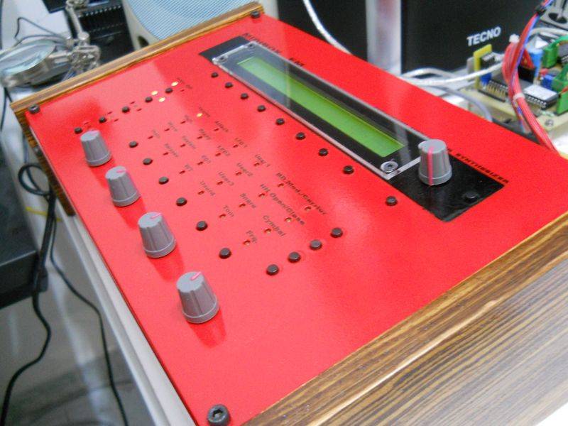

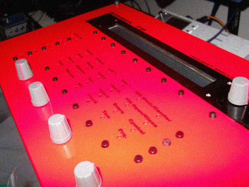

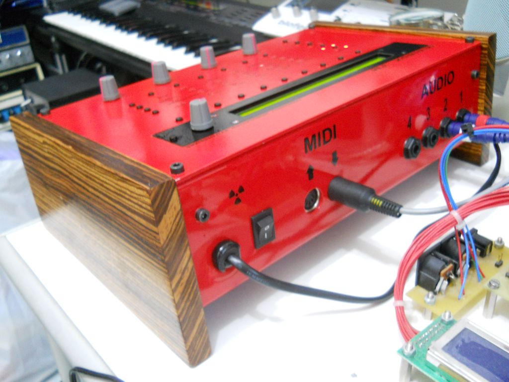

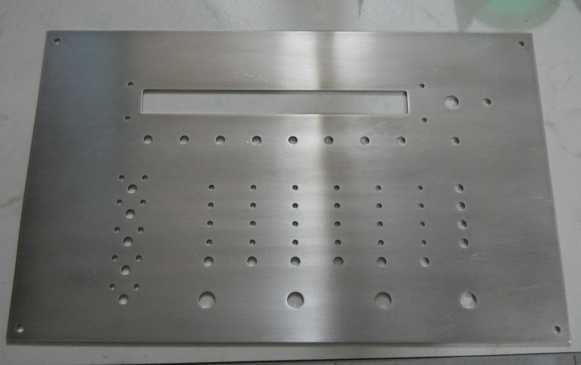

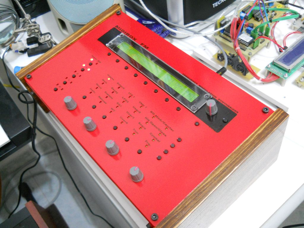

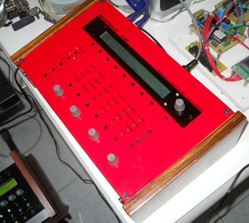

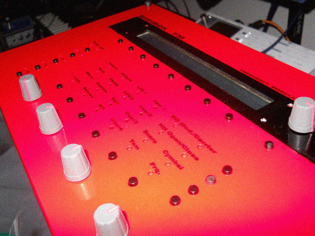

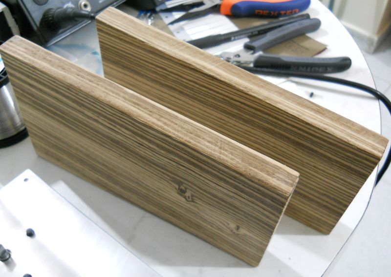

I used MDF wood for the bottom and for the sides I used plywood with Zebrano veneer. The front and the rear panels are aluminium and a friend of mine made lasercutting in his workshop ( I designed it with Front Panel designer )then silkscreen ( an other friends in another workshop ) and at the end a layer of transparent acrylic.

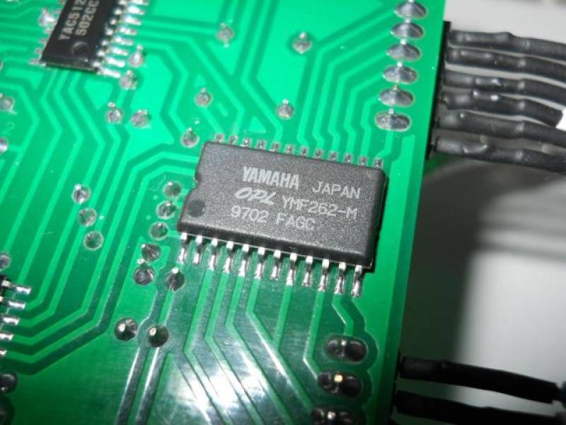

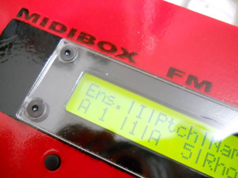

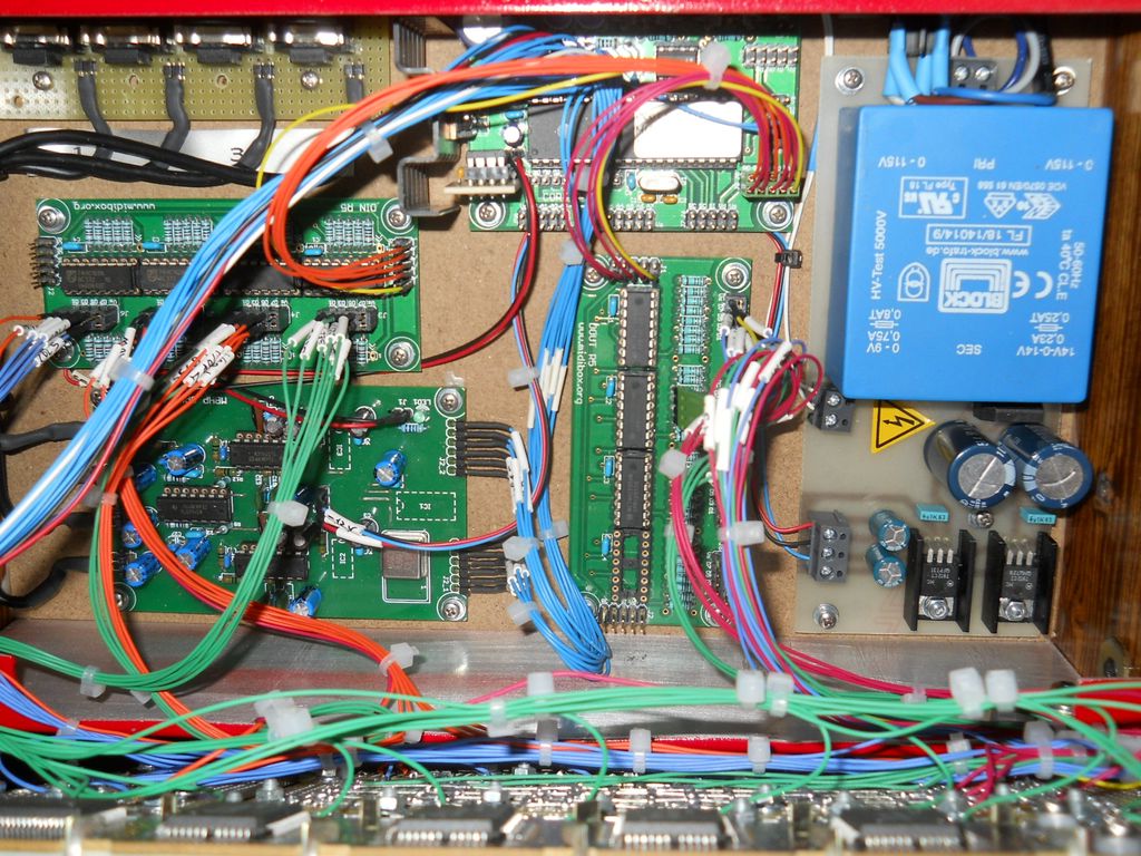

1 PIC core ,1 Din and 1 Dout populated with only three chips. The display is one of the very first hitachi that I bought in the late 90,Saved for this project. Some wiring with a label on every wire against any error

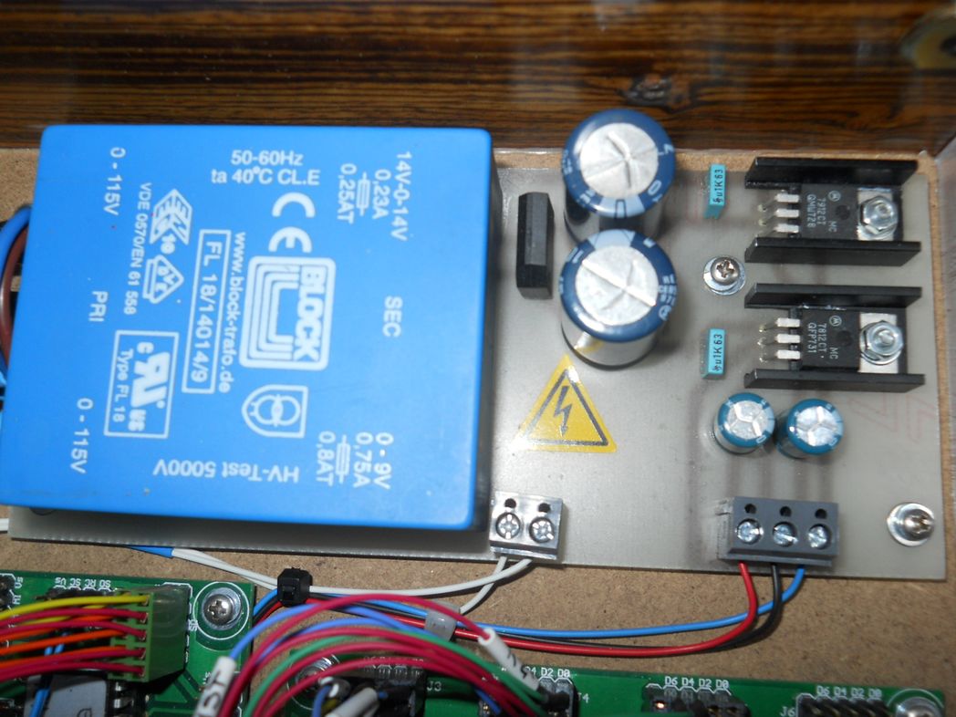

The power supply is made by me with PCB etching and a good quality transformer ( the capacitors are high quality with low SR from railway technology )
