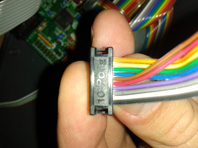

For connecting to a 32-bit Core a special ribbon cable must be prepared when using standard 2*5 IDCs:
Pin mapping:
| Core (STM/LPC) | AOUT_NG | |
| Pin | J19 (top row) | J1 |
| 1 | Vs | Vs |
| 2 | Vd | Vd |
| 3 | SO | CS(=RC) |
| 4 | SC | SI |
| 5 | RC1 | SC |
Wire the Core end 1:1 and connect to J19. Note pin 1 is on the bottom left, on the same side as the polarising notch. Take wires 9 and 10 (red and brown in this image) and insert them between wires 4 and 5 (purple and blue in this image). Shift wires 5-8 over so 5→7, 6→8 etc.
When clamping the connector shut, make sure the wires are straight with no unintended short circuits (0V, +5V and SC use two pins each). Check the Core schematic to be certain.
