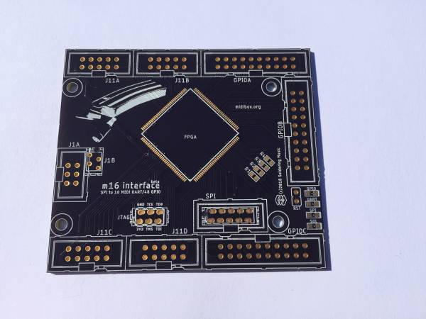

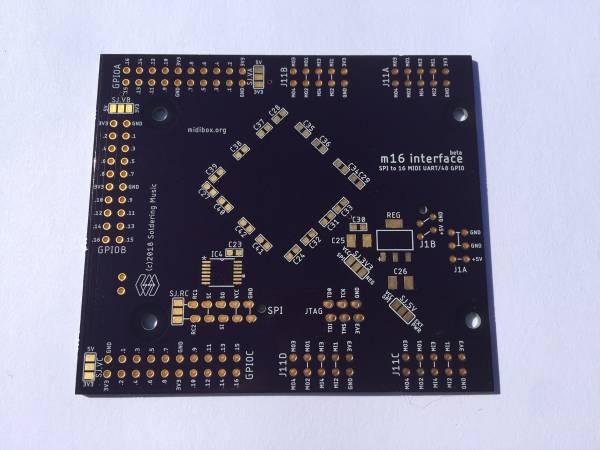

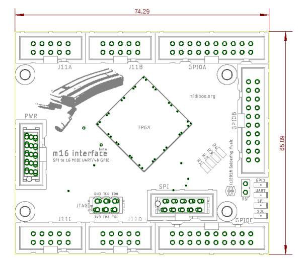

Add 16 MIDI I/O to your Core, SPI Slave Interface with up to 16 UARTs(MIDI I/O), based on low-cost FPGA…
version 1. Mouser BOM:toDo
| Qty | Value | Package | Parts | Mouser | Reichelt | Conrad | Other | Notes |
| Resistors | ||||||||
| 4 | 680R 5% | 0603 | R1, R2, R3, R4 | 667-ERJ-PA3J681V | Depends on Leds | |||
| Capacitors | ||||||||
| 3 | 10n | 0603 | C27, C29, C30 | 80-C0603C103M5RAC | ||||
| 15 | 100n | 0603 | C23, C24, C28, C31, C32, C33, C34, C35, C36, C37, C38, C39, C40, C41, C42 | 80-C0603C104Z3V | ||||
| 2 | 10u | SMC_B | C25, C26 | 647-F931C106MAA | ||||
| LEDs | ||||||||
| 4 | – | 0805 | LED.1, LED.2, LED.31, LED.4 | 755-SML-H12U8TT86C | ||||
| ICs | ||||||||
| 1 | LCMX02-7000 | TQFP144 | FPGA | 842-27000HC6TG144I | Speed grade 4 to 6, 3.3V! | |||
| 1 | 74LVC125 | TSSOP-14 | IC4 | 595-SN74LVC125APWR | ||||
| 1 | LD1117AS33TR | SOT223 | REG | 511-LD1117AS33 | ||||
| Connnector | ||||||||
| 1 | micro-match 2×2 | Male | J1B | 571-215464-4 | for stack | |||
| 1 | 2×3 | Male | J1A | 710-61200621621 | ||||
| 1 | micro-match 2×3 | Female | JTAG | 571-215079-6 or 571-2178710-6 (value line) | ||||
| 5 | 2×5 | Male | J11A, J11B, J11C, J11D, SPI | 710-61201021621 | ||||
| 1 | micro-match 2×5 | Male | SPI | 571-8-215464-0 | for stack | |||
| 5 | 2×10 | Male | GPIOA, GPIOB, GPIOC | 710-61202021621 | ||||
