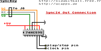

The hardware
It is made of :
  1. A core module
  2. A dout module (if you want to convert Midi → Sync24 )
  3. A din module + a lil board (if you want to convert Sync24 → Midi )

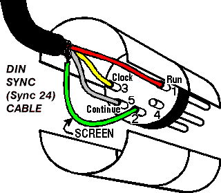

Sync24 Connector
Sync24 Connectors Are Not MIDI Cables
Dont use midi cables as sync24 cables, because the wiring is different, and most often, the pins 1 and 5 used by sync 24 are left unwired in midi cables.
