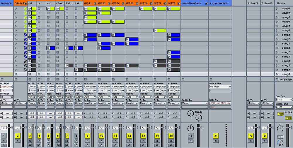

I need potentiometers, I need buttons and I need feedback from Ableton Live. The feedback is done by RGB LEDS.
I decided to use potentiometers screwed on the frontpanel, and to build my own PCB for buttons & leds.

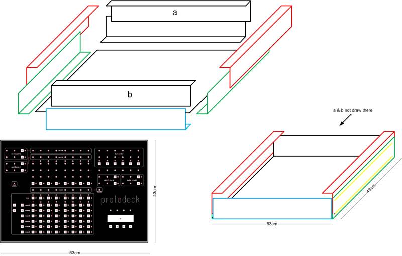

Firstly, I design a layout that matches with my live set.
I'll add more explicit photos, but for the moment, there is only the following schematics (buttons are square, pots are one-bordered circle, leds are doubled-bordered circle)
Protodeck is : 87 potentiometers + 90 buttons + 87 RGB common anode leds
We can see different part in the layout
The clip control matrix is used for clip control (!). It involves 64 buttons + 64 RGB leds.
The first row of button mute the track and gives informations about midi note on and the position of cursor of playing clip (beginning, or near to end)
All song are 6 scenes. I can move a little window of 6 scenes with the 2 buttons on the left and the matrix is updated with the content of the live set.
By pushing a button in the matrix itself, a clip is triggered. Leds give feedback of clipslot state (empty, clip playing, clip not playing)
The track control is used for controlling each 8 tracks. 2 pots for send amount, 3 pots for instruments tweaking, 1 button for changing modes or activate a specific FX and the volume pot.
The first track is the main drums track. This drum track is divided in 6 parts controlled by drum control.
The drum control is used for controlling drum tracks. 2 pots for sound tweaking, 1 button for mute each drum part.
The send control is used for fx rack in send/return track tweaking
The master control is used for master eq and 2 FX racks tweaking. It contains a master volume pot.
The multipurpose section contains 4 pots, a LCD screen and 4 buttons. This part will be finished later. It will probably provide filter sweep and other pre-programmed variation based on dummy clip stuff
The LCD will be involved in this multipurpose way: it could give a feedback of master volume, showing some important informations like the weather of the next day etc.

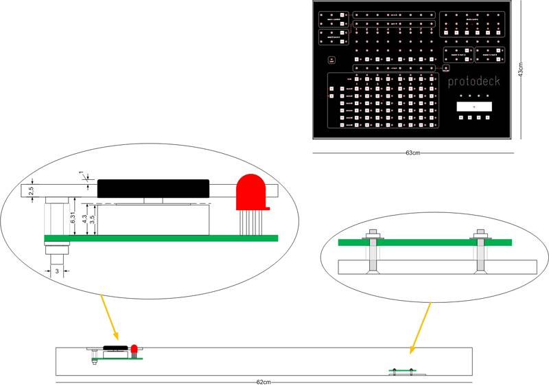

I ordered the frontpanel as soon as I decided the parts I'd use. I ordered it from Schaeffer AG and the result is impressive:

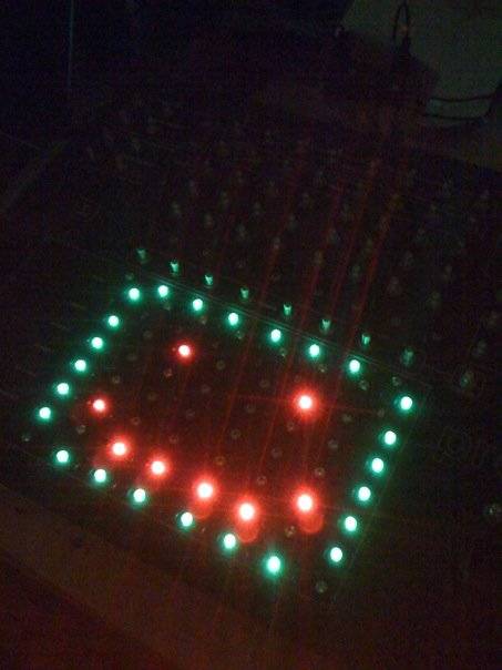

And the leds are ok:
Very awful photos, asap: HIGH QUALITY PHOTO
I decided to screw pots directly on the frontpanel in order to be sure about solidity when I'd use them.
For buttons and leds, I decided to make my own PCB.
I used Kicad, a VERY reliable “open source (GPL) software for the creation of electronic schematic diagrams and printed circuit board artwork”.
I made all the components with datasheet informations in order to be sure my PCB would fit reality.
I ordered PCB from batchpcb.com. They are in USA, I'm in France. It took around 3-4 weeks. Long time when you're as impatient as me, but a correct delay considering the reliability of PCB you receive at home !!!
I made 7 PCBs.
Here are some 3D rendering from Kicad/wings3D in order to see what I expected.
And I received that:
NB: if you checked a bit, you'll find an error. Indeed. and even 2 errors on the big PCB… I had to re-order it in order to get a correctly done PCB.
I put midibox modules at the bottom face and my 7 own PCBs under the frontpanel

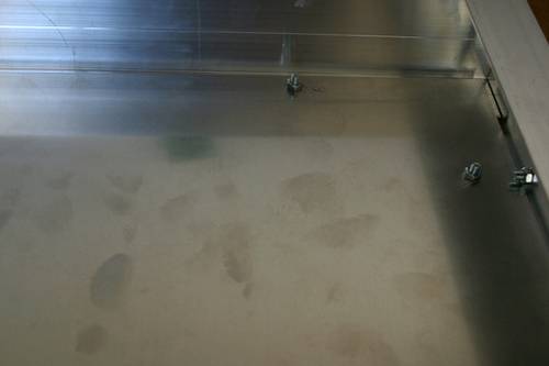

I glued the screws under the frontpanel (Denis St Amand adviced it and … as usual was right!)
I guess I'll modify asap the modules place. Indeed too much cable between the bottom and the frontpanel: it would be better to directly put all modules under the frontpanel, excepted the core at the bottom…
The box was basically made with aluminium corners.
Even if a lot of people thinks I'm a non-finisher-guy, I have to say here that I didn't and won't spend (waste) time to make a perfect box!
Indeed, my way is the music, the code, the design of the interface, not the aesthetic of this box!
“Time is rare, just use it carefully” JB

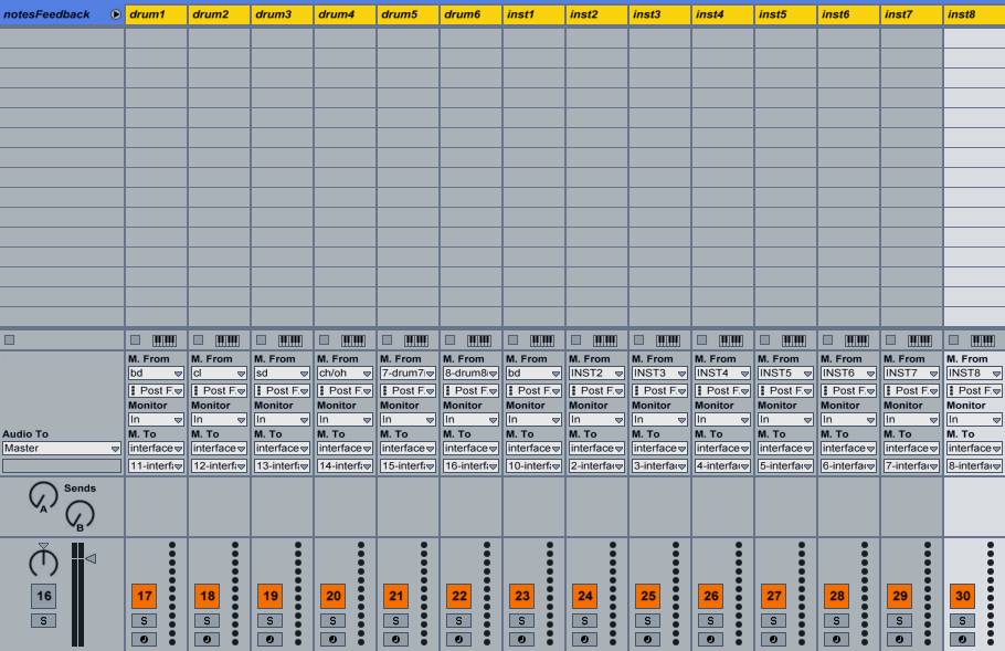

Here is the notes feedback group track deployed:
Here is the first track part, where the big interface brain patch sits:
Here is the last track part, where all the MIDI messages targeted for the protodeck go through:

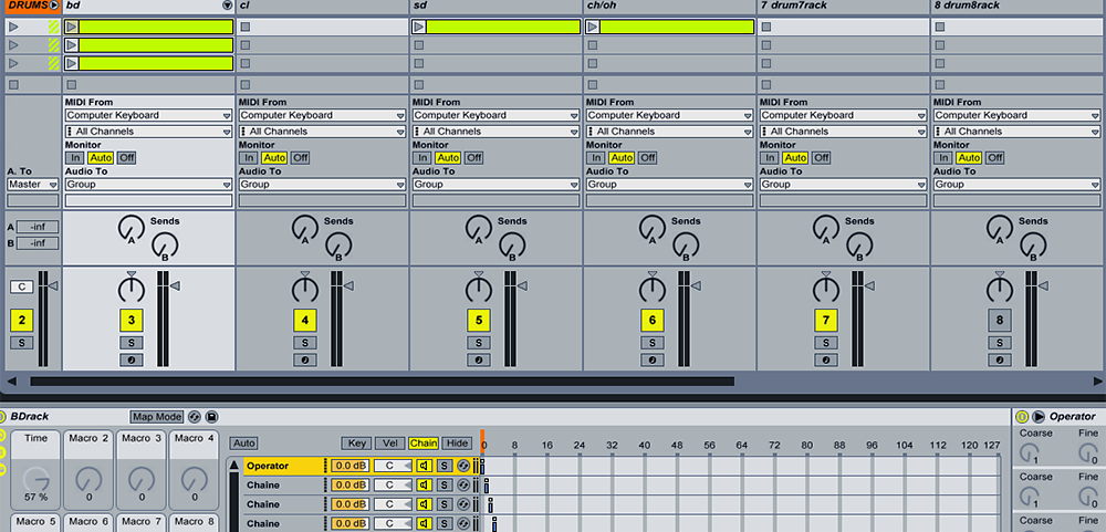

The whole main tracks are 8 tracks.
The first is the Drums section. It is basically a group track with 6 sub-tracks inside.
There are 2 send/return channels.
One liveset = One performance = a set of songs
A song = 6 scenes
Each track, excepted the Drums section, contains an instrument rack with chains. Each chain corresponds with a song.
The sub-tracks in the Drums section are like the other tracks: an instrument rack inside, with chains:

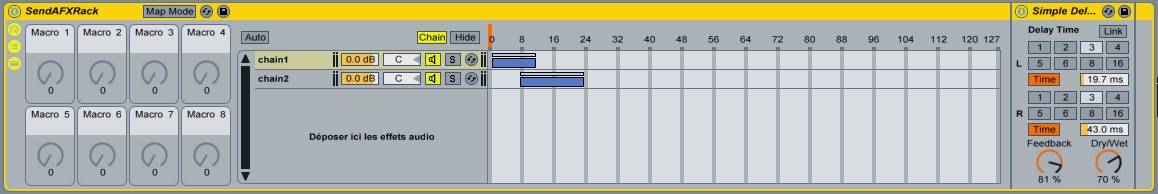

Each send/return contains an FX rack with 2 chains corresponding with 2 set of effects.

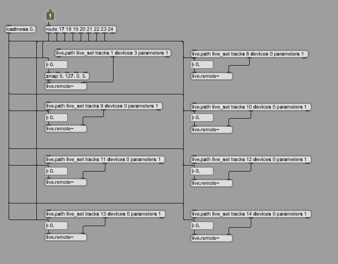

PROTODECK.POTS (handling of potentiometers)

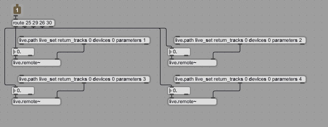

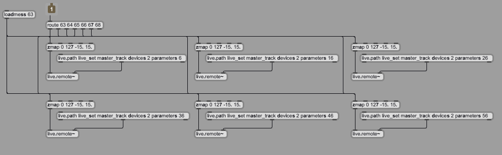

Here I map control changes midi messages from the protodeck to the Live through the API.
First, I'm selecting all control changes midi messages from the channel 1 in order to save cpu time…
After that, I send the selected flow to a lot of sub-patches.
The live.remote~ object is the one most used!
Indeed, it provides a signal rate control instead of using the live.object + set values message that permit automation and thus undo level…
Live.remote~ blocks mouse tweaking, but is the one to be used for hardware controller use.

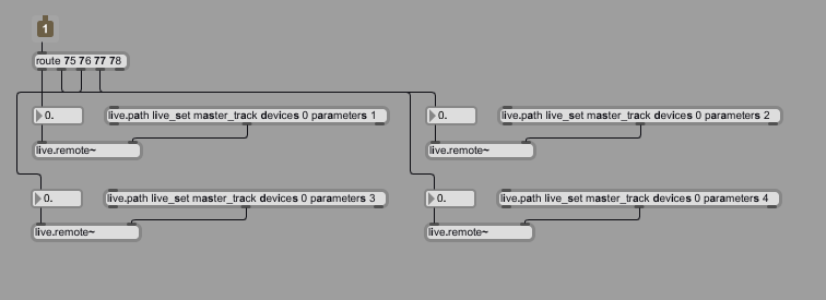

[p returnAControl] & [p returnBControl] subpatches
Here, I mapped macro 1, 2, 3 & 4 of the rack inside each return tracks.

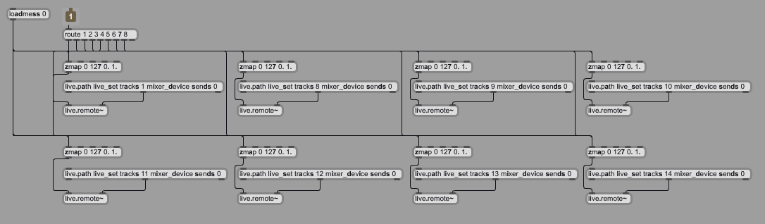

[p sendATracks] & [p sendBTracks] subpatches
These patches controls the rate of each track audio signal sent to the 2 return tracks.

[p EQ] subpatch
This patcs controls an EQ8 on the master.

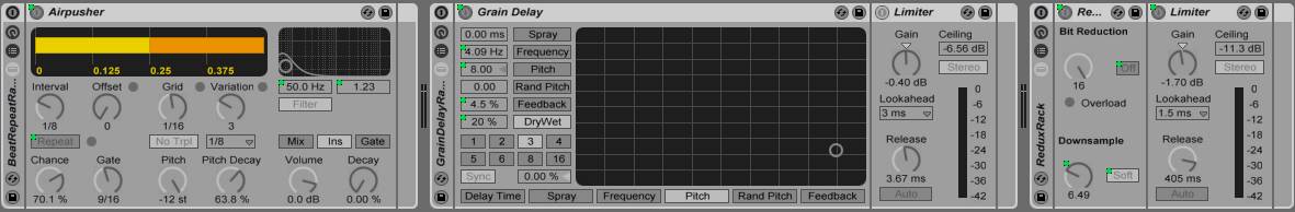

I put 3 racks with an fx in each rack. check it:
The patch maps potentiometers with one macro per rack.
Each macro controls more than one parameter.

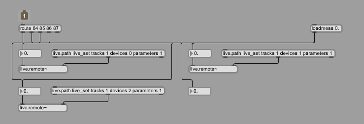

[p instrumentsMacros1] subpatch
In each track, a rack with an instrument in each chain.
One pots in each track controls the first macro of each rack.

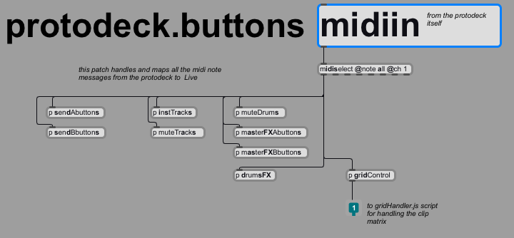

PROTODECK.BUTTONS (handling of buttons)
Here I map midi notes messages from the protodeck to the Live through the API.
First, I'm selecting all midi notes messages from the channel 1 in order to save cpu time…

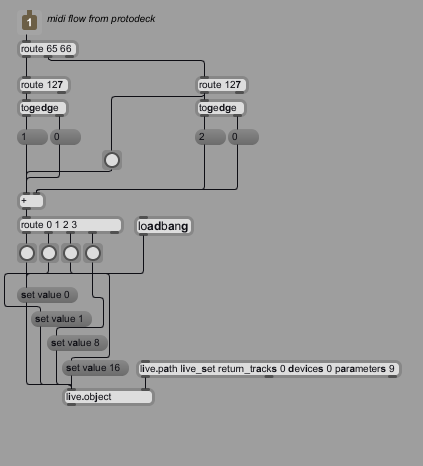

[p sendAbuttons] & [p sendBbuttons] subpatches
This patch is interesting and is used for [p sendBbuttons] & [p mastFXAbuttons] & [p mastFXBbuttons] subpatches.

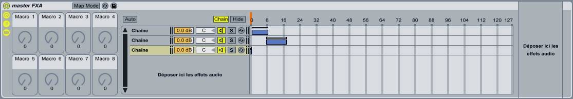

The concept is easy to understand: I have racks with 2 & 3 chains inside forsend A, send B & 2 differents racks in the master section.
Look at these :
when the chain selector is:
- 0 means no FX
- 1 means the signal is processed by the chain 1
- 8 means the signal is processed by the 2 chains
- 16 means the signal is processed by the chain 2
The following patch mapped 2 buttons to this behaviour.
I push the first button, the chain 1 processes the signal.
I push the second button, the chain 2 processes the signal.
and the 2 other case (no button pressed, or the 2 buttons pressed)
This is a toggle behaviour: I push/release, it is enabled. I repush/release, it is disabled.
This concept/behaviour is all the same for [p sendAbuttons] & [p sendBbuttons] & [p mastFXAbuttons] & [p mastFXBbuttons] subpatches.

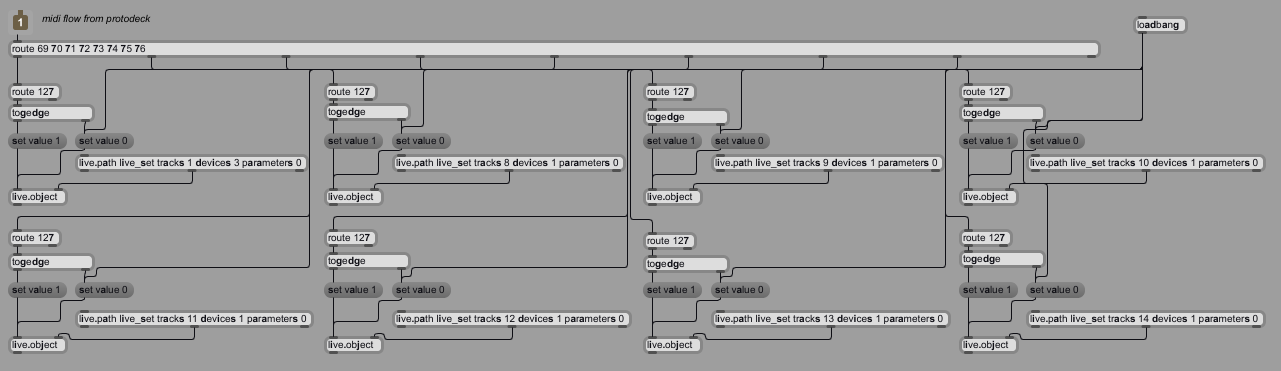

[p instTracks] subpatch
This patch activates/deactivates the autofilter in a track.
Each track includes an autofilter.

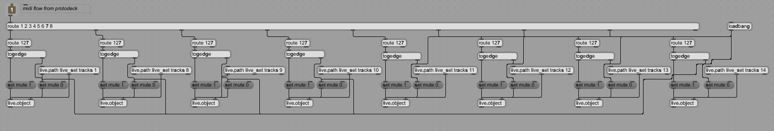

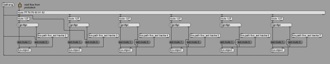

[p muteTracks] subpatch
This patch basically mutes/unmutes each track.
[p muteDrums] subpatch
This patch basically mutes/unmutes each drum track.

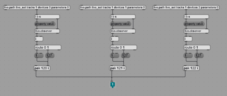

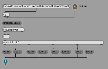

The fx state observer sub-patches
Let's begin by those FX states ( sendAState, sendBState, masterAState & masterBState works all the same)
The tip used here is the same the one explained before about controlling FX status… (of course)
I light on/off some leds and it is made automatically when status change.

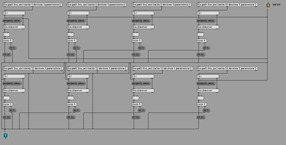

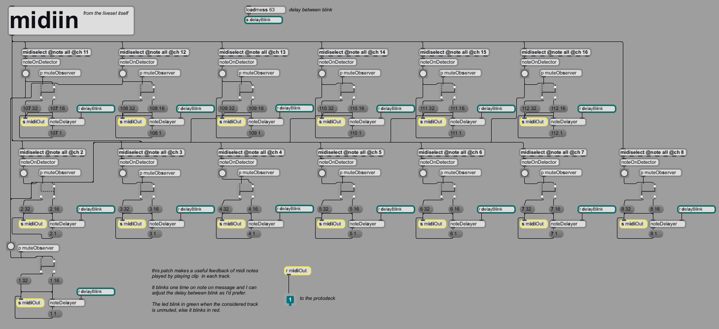

[p midiNotesFeedback] (feedback of each midi notes in each track)
If a note is played in one track, a little green blink occurs.
If the track is muted, but a clip is playing notes, these blink are red in order to make me know the track is playing but muted.
The noteDetector is a basic abstraction I created to fit my need.
The point is the workaround I used with those dummy tracks only used for routing inside the patch (see before)
The noteDetector is:
The blinking feature SHOULD be implemented in the protodeck firmware.
I didn't do that even if I have the C code.
Time is only for music at this moment so … let go there: soundcloud.com/protofuse

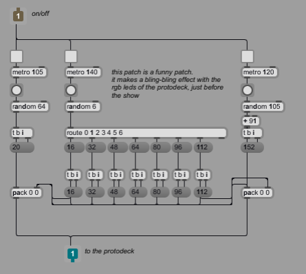

[p christmas] (only for making fans happy)
It tranforms the protodeck in a pretty christmas tree.

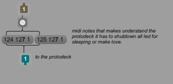

[p allLedsOff] (clear all the leds matrices)
It is a good example about what to put in the firmware (HARD) or in the patch (SOFT)
if I'd want to put that on the software side, I'd need one message midi note per led to switch off all leds………..
I'd prefer to save my midi link, and use a basic firmware clear triggered by only one message (= one per matrix = 2 messages to clear all the protodeck)

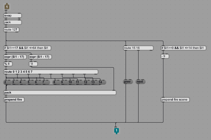

The [p gridControl]
This patch map buttons from clip grid on the protodeck to the javascript code.
It sends messages directly to the script.
These messages are:
- triggering a clip
- triggering scene
- moving the 8×6 protodeck observing grid up or down inside the liveset

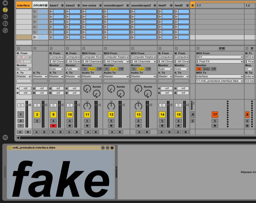

THE TIP FOR COMPOSING & PERFORMING WITH THE SAME LIVE SET WITH & WITHOUT THE HARDWARE
I need to tweak and test the sounds I'm creating at each time.
When I use live.remote~, the parameter mapped is locked and I must use the potentiometer for tweaking it.
The first way was to create a system to send the message id 0 to ALL live.remote. It is a workaround.
I found another workaround simplier (for me)
I'm using a fake max for live patch.
Why not removing basically the patch instead of replacing it ??? Because all the routing for note feedback would have to be redone!
So with the fake, I can grab it easily.
I want to compose in the bus/plane, I compose.
I come back home, I plug the protodeck, I replace the fake by the real one. I test the song.
I go to bed, I replace by the fake, I test etc etc
It works. It is simple. I like it!
