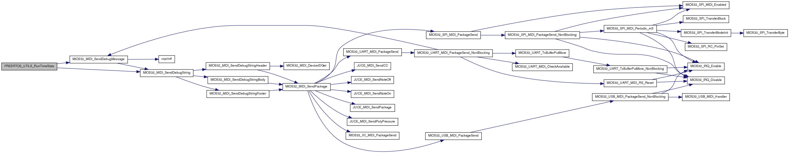

s32 FREERTOS_UTILS_RunTimeStats ( void   )
Use this function to send the performance stats to the MIOS terminal via MIDI
Returns:
< 0 if MIDI output failed
