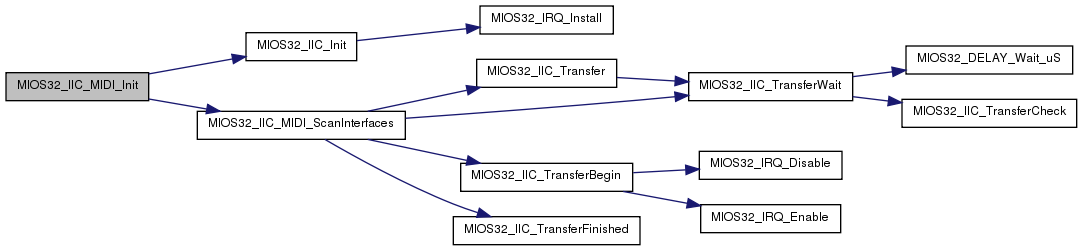

s32 MIOS32_IIC_MIDI_Init ( u32  mode  )
Initializes IIC MIDI layer
Parameters:
[in] mode currently only mode 0 supported
Returns:
< 0 if initialisation failed
Note:
Applications shouldn't call this function directly, instead please use MIOS32_MIDI layer functions

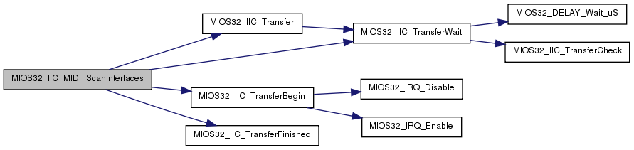

s32 MIOS32_IIC_MIDI_ScanInterfaces ( void   )
Scans all MBHP_IIC_MIDI modules to check the availablility by sending dummy requests and checking the ACK response.
Per module, this procedure takes at least ca. 25 uS, if no module is connected ca. 75 uS (3 retries), or even more if we have to wait for completion of the previous IIC transfer.
Therefore this function should only be rarely used (e.g. once per second), and the state should be saved somewhere in the application
Returns:
0 if all IIC interfaces scanned
-2 if IIC interface blocked by another task (retry the scan!)
