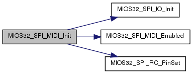

s32 MIOS32_SPI_MIDI_Init ( u32  mode  )

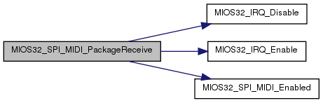

s32 MIOS32_SPI_MIDI_PackageReceive ( mios32_midi_package_t package  )
This function checks for a new package
Parameters:
[out] package pointer to MIDI package (received package will be put into the given variable)
Returns:
-1 if no package in buffer
>= 0: number of packages which are still in the buffer
Note:
Applications shouldn't call this function directly, instead please use MIOS32_MIDI layer functions

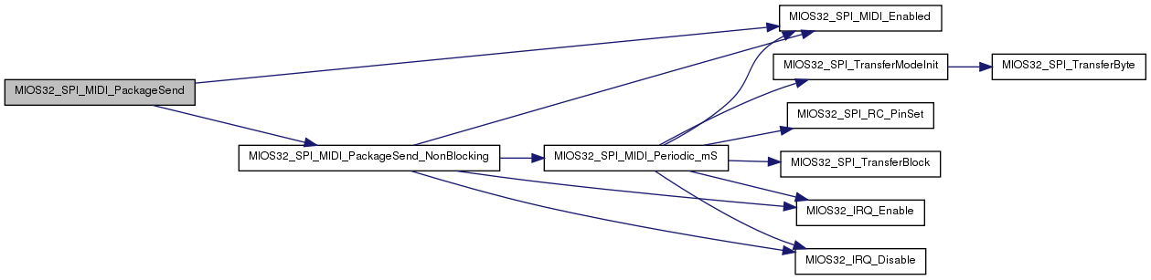

s32 MIOS32_SPI_MIDI_PackageSend ( mios32_midi_package_t  package  )
This function puts a new MIDI package into the Tx buffer (blocking function)
Parameters:
[in] package MIDI package
Returns:
0: no error
-1: SPI not configured
Note:

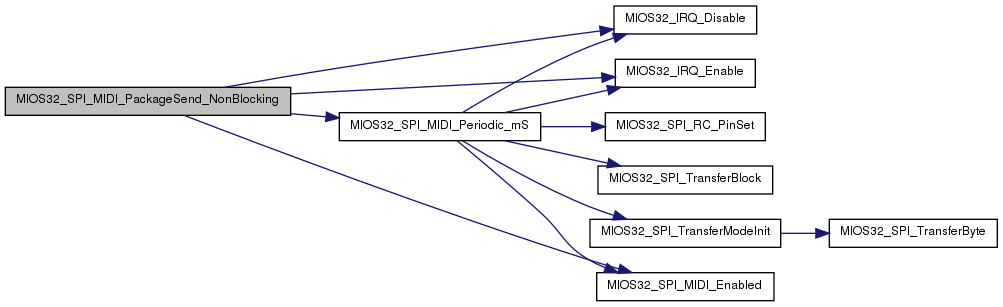

s32 MIOS32_SPI_MIDI_PackageSend_NonBlocking ( mios32_midi_package_t  package  )

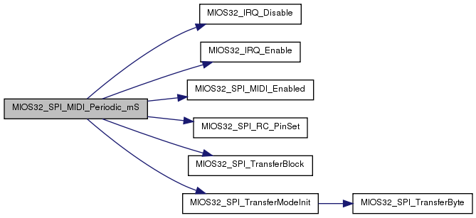

s32 MIOS32_SPI_MIDI_Periodic_mS ( void   )
This function should be called periodically each mS to initiate a new SPI scan
Not for use in an application - this function is called from MIOS32_MIDI_Periodic_mS(), which is called by a task in the programming model!
Returns:
< 0 on errors
