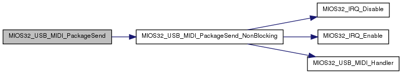

| s32 MIOS32_USB_MIDI_PackageSend | ( | mios32_midi_package_t | package | ) |
This function puts a new MIDI package into the Tx buffer (blocking function)
| [in] | package | MIDI package |

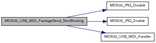

| s32 MIOS32_USB_MIDI_PackageSend_NonBlocking | ( | mios32_midi_package_t | package | ) |
