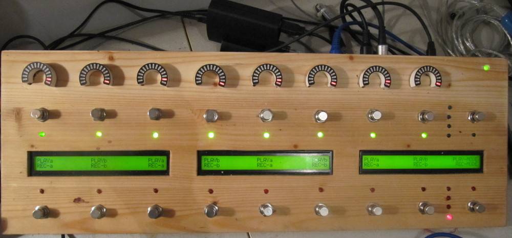

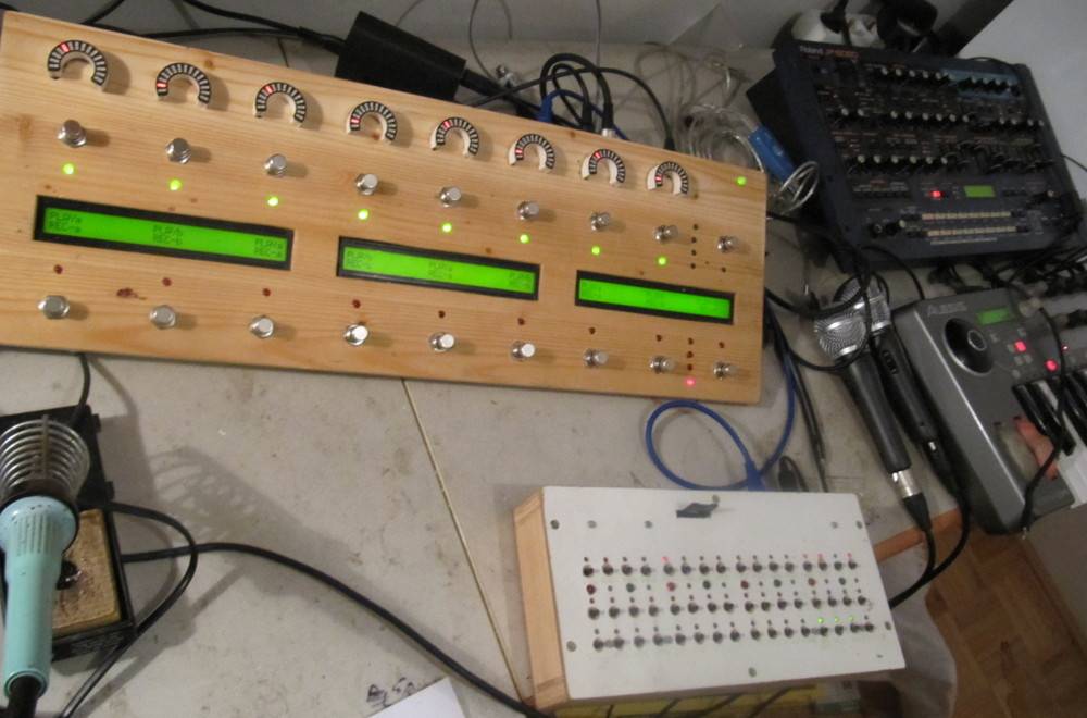

Specs ?
4 Midi-Channels: 1 2 3 4
–2 Tracks a Channel
–8 Notes-Chord a Track
–each track has a dedicated and changeable loop-length from 16 to 256 Steps (example for 4-4)
–each Track can played single and booth tracks can be played simultan/in-dual
Fixed Velocity @ 127
–no Keyboard-Velocity-sense (Triggermatrix does the job of sensing drum trigger in order to re-trigger the moldy buffer
16th fixed note-trigger-rate
–puts out note-data in 16rate (in order to provide a steady note stream for Triggermatrix)
–a connected Triggermatrix (allows not only 4-4, all other things like 5-4 are possible!)
–Triggermatrix does the job of melody-rythm-re-triggering}
512 Songs saved on SD-Card
–Load-able while playing - when the beat-structure is the same
the Midi-System-Setup
–fixed/hardcoded (Midi-Ports, Midi-Channels))
MidiPort 32-in:
–Midi-Clock-Source, Start-Stop, ProgramChange @ MidiChannel 1
MidiPort 33-in:
–connected to a Midikeyboard @ MidiChannel 1
MidiPort 33-out:
–connected to Triggermatrix -Melody-In-Port, or a poly-synth)
Footboard-Interface
fabricated PCB-Version
not planed!
Community users working on it
  • Phatline = Programming, Documentation, Hardware-Prototype
