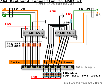

Since Thorsten released a 8*8 scan matrix driver,
it's easily possible to use a C64 Keyboard with MIOS.
http://www.midibox.org/forum/index.php?topic=6505.msg40727#msg40727

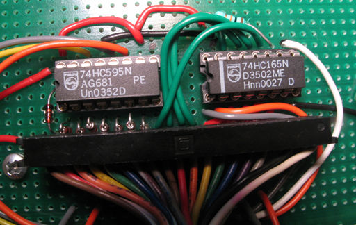

First, i did this pcb (on a breadboard) :

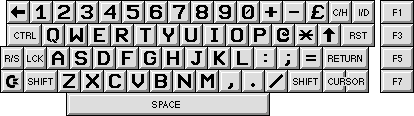

Use that sample program to test your keyboard connection : (sources included) - http://jambonbill.free.fr/midibox-kb/c/c64-keyboard-test-v2.zip It display the key number, the corresponding Character, the midi note number associated to that key, and play a note on channel 1. The keyboard mapping can be found in the “variables.h” file.
