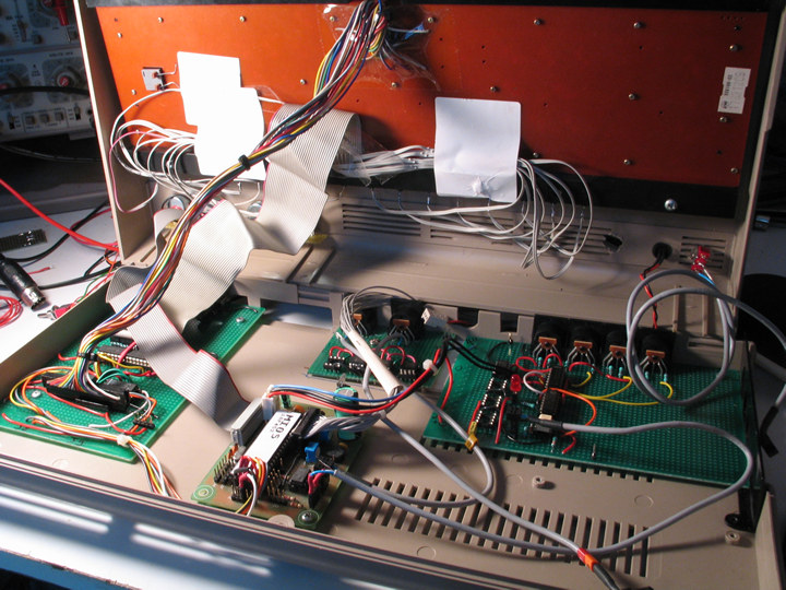

First, i did this pcb (on a breadboard) :

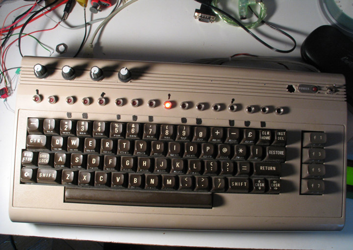

It can look like this

More photos
jambonbill.free.fr_midibox-kb_photos_mbkb-01.jpg jambonbill.free.fr_midibox-kb_photos_mbkb-02.jpg
