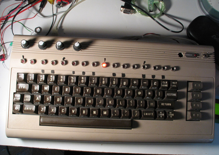

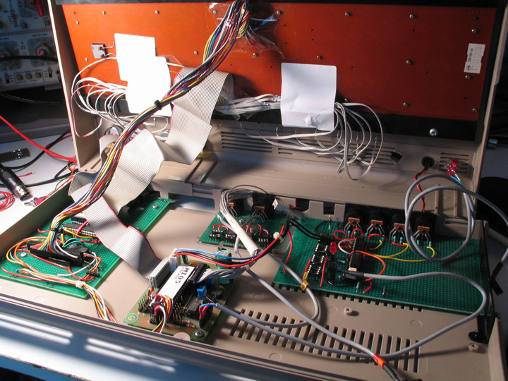

First, i did this pcb (on a breadboard) :
The program
Use that sample program to test your keyboard connection :
This small app display the key number, the corresponding Character, the midi note number associated to that key, and play a note on channel 1. The keyboard mapping can be found in the “variables.h” file. More than a test, it's a good base for your own programs.
A bigger and more interesting program (a funky sequencer) is still on developpement… stay tuned !
It can look like this

More photos
jambonbill.free.fr_midibox-kb_photos_mbkb-01.jpg jambonbill.free.fr_midibox-kb_photos_mbkb-02.jpg
Bugs
Atm, some key combination lead to errors : The C64 keyboard pcb do not have signal leds. So, when you try to play some chords (no worry, only o a few of them) the scan matrix do not read the keyboard correctly. I guess that problem exist on the real C64, but is not a problem because there's no need to press 4 keys at the same time, in a normal way of use.
