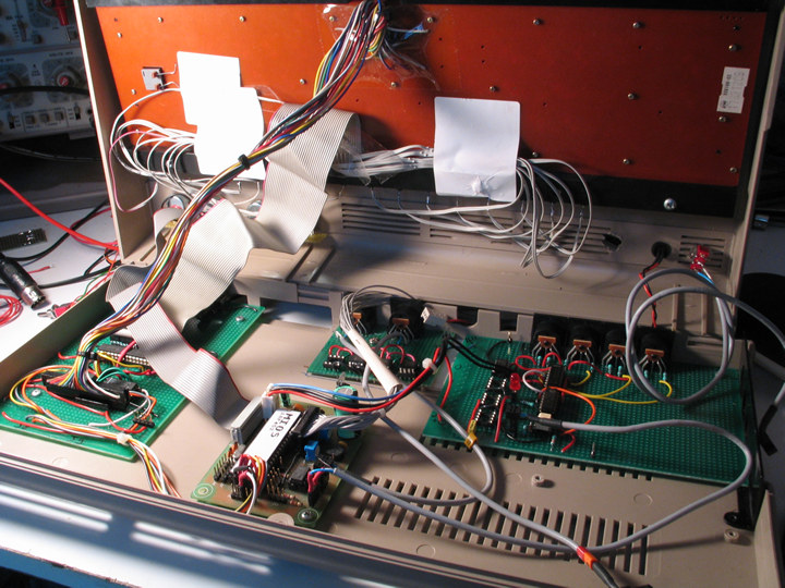

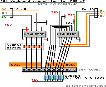

First, i did this pcb (on a breadboard) :

More photos
jambonbill.free.fr_midibox-kb_photos_mbkb-01.jpg jambonbill.free.fr_midibox-kb_photos_mbkb-02.jpg

Atm, some key combination lead to errors : The C64 keyboard pcb do not have signal leds. So, when you try to play some chords (no worry, only a few of them) the scan matrix do not read the keyboard correctly. I guess that problem exist on the real C64, but is not a problem because there's no need to press 4 keys at the same time, in a normal way of use.
