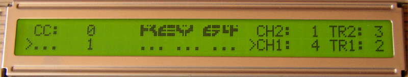

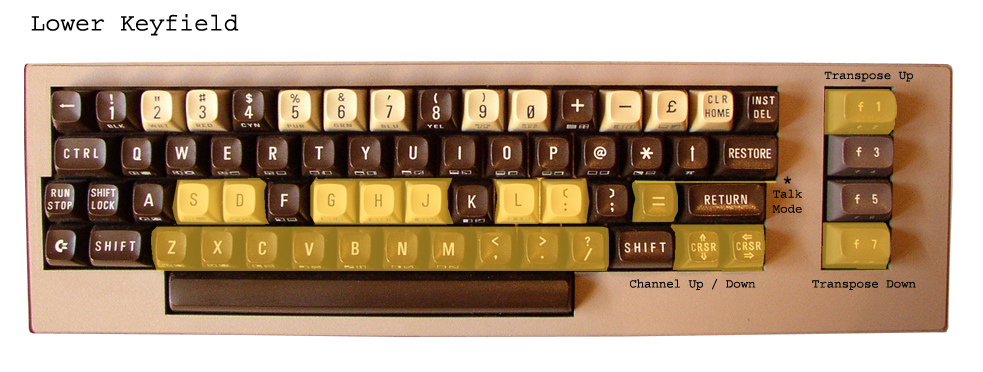

The main screen displays the adjustable midi settings to use the C64 keyboard as a splitted midikeyboard with UPPER and LOWER Keyfield. Maybe you can use it to play or control external device (SEQ, Syntheziser, K2) seperatly. I'm often using the LOWER keyfield to transpose SEQ tracks and SpeakJet pitch at same time by SEQ's internal router. Maybe the UPPER keyfield can be used for playing notes or chords directly.
In the middle of screen the current playing midi notes are displayed. Notice that only 3 keys are possible at the same time. That's a restriction of the keyboard matrix, because pushing a 3th key in same row/col will short-circuited some other keys in matrix. To solve that problem as good a possible, i've implemented an additional HOLD Mode (press RETURN and a “+” will be shown besides CH1). It's easier to play chords and to hold them without holding down all the keys. In HOLD Mode an additional 4th note can be played in the lower Keyfield too - so 3th chords in the upper field and e.g. a bass line in the lower field can be played and changed at same time. You can release all notes by pressing CTRL. You can switch off HOLD Mode by pressing RETURN again. The state of HOLD Mode will be stored internal.
If a played chord is known, it will be shown on the left side of note view:
Play chords / notes in a simple way:
On the right side of screen the adjustable channel- and transpose-values for UPPER and LOWER keyfield are shown. CH1 (for LOWER keyfield) can be changed with CRSR keys up down, CH2 (for UPPER keyfield) is variable by + and -. Pushing F1 and F7 will change the transpose value (TR1). For the UPPER Keyfield TR2 is adjustable in 2 ways: Pushing SHIFT_R + F1 and SHIFT_R + F7 or pushing simply the SPACE key. A short touch of the space button transposes TR2 up, a longer touch transposes TR2 down. All Parameters will be stored internal.
On the right side of screen the adjustable CC and CC Values are shown. The pointer char “>” infront of Midi-Channel presents the current Channel for a choosen CCs. SHIFT_R + ? switches the CC pointer between the 2 keyfields. CCs are adjustable with F3 and F5. The Keys COMMODORE and SHIFT_L presents the datawheel of K64. CC Values are sended out by moving CC Value up and down with that keys. INST/DEL Key sets values back to 0.

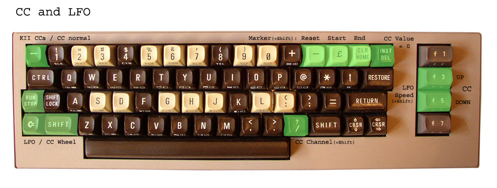

There is an integrated LFO option to automate some functions of the datawheel. The LFO option changes the CC Values in a specific interval up and down. Close to CC Value area, there are 2 marker adjustable. The Startpointer “>” on the left and Endpointer “<” on the right side. The Start marker is adjustable by pushing SHIFT_R + LIRE key - the end marker by SHIFT_R + CLR/HOME. Changes adjust the border for triangle LFO. SHIFT_R + “-” Key resets default marker position (0..127).
To Start the LFO press RUN/STOP. To Stop the LFO press RUN/STOP again. You can influence the flow by controlling CC Values manually, changing end- and start-position and setup Speed Value.
Start Marker:
End Marker:
The speed value (default = 1) behind the value number presents the speed of changing CC Values, which are controlled by datawheel or by LFO. Manual changes are constantly double fast as LFO. Pushing SHIFT_R + F3 or SHIFT_R + F5 will change the speed value. Notice, if the speed value is 0 the LFO will be frozen.

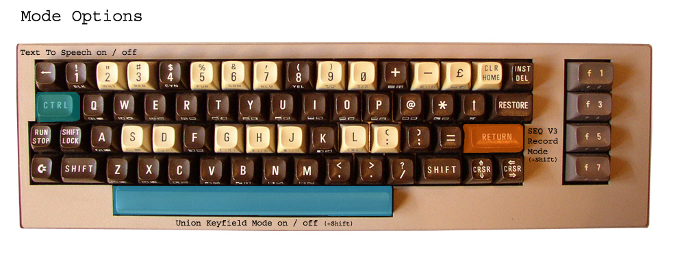

The Union Mode binds the lower and upper Keyfield. All notes will be sended out to the single Midi Channel.
People, which own's a MIDIBox SEQV3 are able to use this special feature to record or to modify parameters as easy as possible from K64. Every step of a track can be controlled by Cursorkeys, toggling notes (Space Key) or recording notes from Keyfield.
The Record Mode is available by pushing SHIFT_R + RETURN in mainscreen. Note!! Only SEQ versions higher than SEQ V3.2a will work correct. All you have to do: Set up the same midichannel for SEQV3 midi-in and K64 (lower) keyfield.

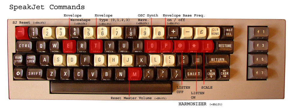

If you've installed the K2 and SpeakJet-Board and if you want to control the SpeakJet for Text to Speech, you can change the main screen to TTS screen by pushing CTRL. If you press CTRL again, you will be back in main screen.
If you want to change SpeakJet CCs instead all CCs, press ←.
If you push SHIFT_R + ← you will change to Synth Mode of SpeakJet. Push ← again, you will turn back to main screen.
SpeakJet Parameters are: (OS1…5) pitch of OSC 1,2,3,4,5; (VO1…5) volume of OSC 1,2,3,4,5; frequency of Envelope (ENV); Distortion-Level of OSC 4 and 5 (DIS); global Speech Speed (SPD); global Speech Bend (BND); Jaw (JAW) and Tonque (TON).
Remember SpeakJet control is only available, if K64 modul is linked to K2 modul via MIDI.
The SpeakJet can be configured with following Keys:
SHIFT_R + E toggle Envelope Type (saw, sin, tri, sqr)
Toggles Envelope Type will only be shown on K2 Display. Parameter E changes to several waveforms.
SHIFT_R + T toggle Envelope State (0,1,2,3)
Toggles Envelope State will only be shown on K2 Display. Parameter T changes to 0,1,2,3.
Bit 1: activates Envelope for OSC 123
Bit 2: activates Envelope for OSC 45
So T = 3 will link all OSCs to the Envelope.
SHIFT_R + O toggle OSC for OSCSynthese
Toggles OSC Waveform for OSCSynthese.
If something goes wrong, or something isn't adjusted right with SJ anymore, it's possible to reset the speakjet with key combination SHIFT_R + ←.
Some more function for configuration the SpeakJet are described on keymap.

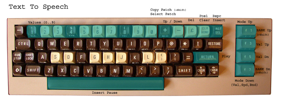

If Talk Mode enabled (SHIFT_R + = ) then the current selected text patch will be sended out by pressing keys on the lower keyfield. You can play the correct tone scale at Midi Channel 4.
First we changed from mainscreen to TTS Screen by pushing CTRL. Now the first patch will be shown. If nothing is stored before, only a blinking cursor will be displayed. Now you can write a word or a sentence. Notice that the application is preconfigurated for german language (because german words are easier pronounceable from text as any other language. E.g. english are very different between written letters and spoken text - many algorithmics have to be implemented to meet all requirements for a TTS).
Ok, we will try to write a german sentence:
The upper line is for writing input (max. 32 characters for patches are allowed). A space character will insert a pause. The cursor can be moved by CRSR Keys to a special position in word. On the left side you can choose the current bankstick (SHIFT_R + F1 / SHIFT_R + F7) and the current patchnumber (+ / -). The lower line represents different configurations for every letter.
LIRE - delete
INST/DEL - backspace
SHIFT_R + INST/DEL - insert
CLR/HOME - Pos1
SHIFT_R + CLR/HOME - Clear
RETURN key or any MIDI-IN Notes at Channel 13 or Channel 14 (bended) will send out the phrase. Midi-IN Channels 1..12 are used to activate the text patches of bankstick.
Ok, we should fine tune pauses in sentence. Go to the space positions and write down a number or using F3 / F5 keys. Higher values will insert longer pauses. Try following:
Ok, we should fine tune variations of letters. We change the letter “E” in “WELTRAUM” and the first “E” in “WEITEN”. Use F3 / F5 to change numbers below letters and listen to the result:
Der Weltraum with pauses and variations
Every letter can be changed by variations. The number of variations is different for every letter. Try to find out the best combinations for your words.
Now we want to do changes in Speed and Bend. Pushing F1 / F7 will change “VAL” to submenu “SPD” and “BND”. Try to added following changes in both and listen to the results by pushing RETURN:
SPD and BND settings will change global settings for SpeakJet. So next speakjet events (e.g. next spoken letter) will use the last values for Speed and Bend. The normal value for Speed is 8 and for Bend 4.
At least you are able to store the patch on current patchnumber by pushing SHIFT_R + RETURN. A Message will be shown. Every 32K Bankstick can store 256 Patches; 64K Bankstick can store 512 Patches.
If you want to copy the text phrases to another position: Hold down SHIFT_R and choose the new patchnumber by + / - keys. Notice, old patches will be overwritten.

CTRL stop current playing notes otherwise select TTS Mode
Z..? note Ch1 S..[ halfnote Ch1
Q..UPARROW note Ch2 2..0 halfnote Ch2
RETURN activates/deactivates Upper keyfield Hold-Notes mode (+) SHIFT_R + RET. activates/deactivates SEQV3 Record mode SHIFT_R + SPC. activates/deactivates Union mode (for non-splitted keyfield) SHIFT_R + = activates/deactivates Talk mode for lower keyfield (*)
SPACE short time - transpose up for Ch2 long time - transpose down for Ch2

RUN/STOP Start LFO / Stop LFO
CLR/HOME Reset CC Value (CC Value = 0)
SHIFT_R + INST/DEL Set LFO END mark SHIFT_R + LIRE Set LFO START mark SHIFT_R + - Reset LFO marks
CRSR_LR Ch1 up CRSR_UD Ch1 down SHIFT_R + CRSR_LR Ch2 up SHIFT_R + CRSR_UD Ch2 down
F1 Transpose1 up F7 Transpose1 down SHIFT_R + F1 Transpose2 up SHIFT_R + F7 Transpose2 down
F3 CC up (KII CC up) F5 CC down (KII CC down)
SHIFT_R + F3 Increment LFO Speed SHIFT_R + F5 Decrement LFO Speed (If Speed 0 - LFO will hold)
SHIFT_R + ? Select CC outgoing Channel
SPEAKJET CONTROL dependend from installed K2 version: ----------------------------------------------------- SHIFT_R + E toggle Envelope Waveshape (saw, sin, tri, sqr) SHIFT_R + T toggle Envelope OSC State (0,1,2,3) SHIFT_R + O toggle OSC Waveshape for OSCSynthese SHIFT_R + P toggle OSC Envelope Basefreq SHIFT_R + M resets Mastervolume = 127
SHIFT_R + @ Harmonizer listen key OFF SHIFT_R + * Harmonizer listen key ON SHIFT_R + UPARROW Harmonizer scale (0,1,2)

—————- Text to Speech Mode ———————————————————————————————————
CTRL select Keyboard Mode A..Z Write Letters SPACE Write Pause (Space) RETURN play/send current speech text
CLR/HOME Pos1 SHIFT_R + CLR/H. Clear Text
INST/DEL Backspace SHIFT_R + INST/D. Insert Space
LIRE Delete Letter + Text Patch up - Text Patch down
SHIFT_R + '+' Copy Patch to higher patch position (at shift key up) SHIFT_R + '-' Copy Patch to lower patch position (at shift key up)
F1 MODE up (VAL, SPD, BND) F7 MODE down (VAL, SPD, BND)
SHIFT_R + F1 BANK up SHIFT_R + F7 BANK down
F3 MODE value up (0..9) 0 - not displayed F5 MODE value down (0..9)
VAL: ------- 0 - Standard LETTER 1..x - LETTER Variations
SPACE VAL (PAUSE) -------------------------------- 0..9 - SHORT...LONG
SPEED: ------------ 1..9 - SLOW..FAST 0 - IGNORE
BEND: ------------ 1..9 - LOW..BRIGHT 0 - IGNORE
