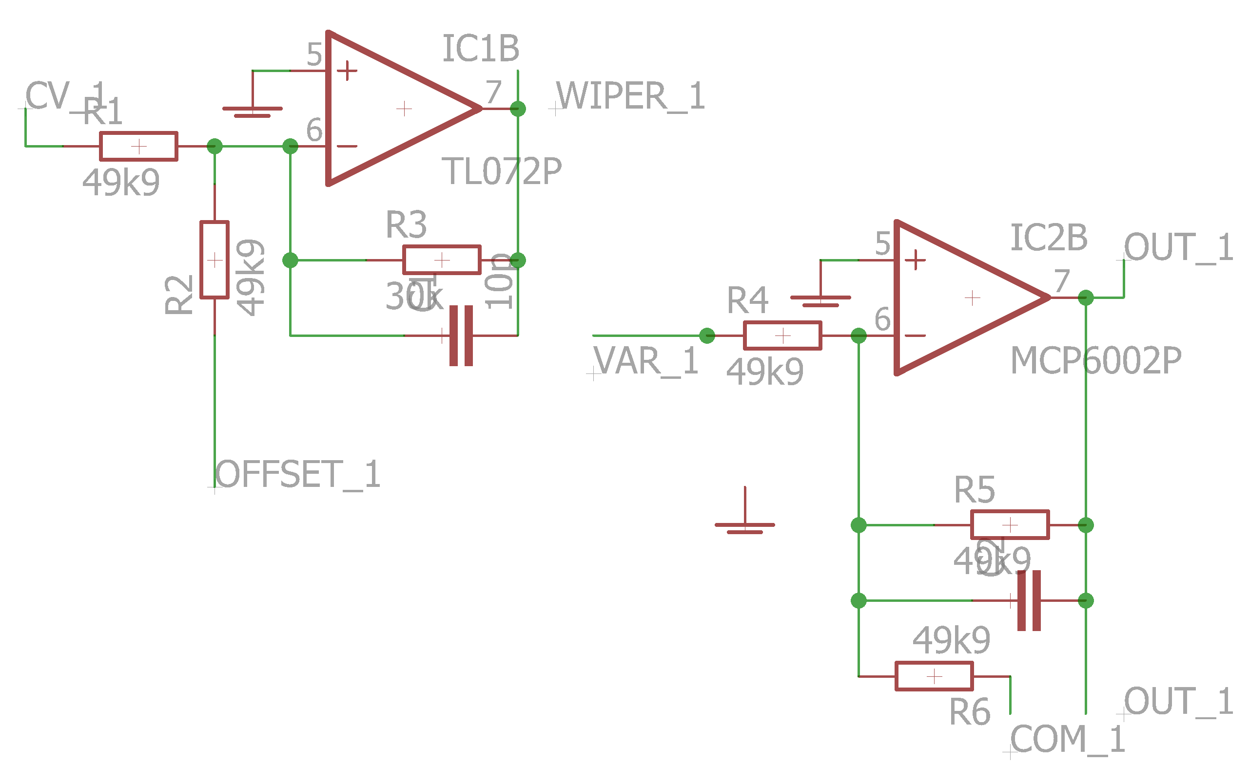

This is a simple way of scaling CVs (as might come from a modular) ready for an STM322F4 Core module.
Schematic
The circuit is a very simple series of two inverting amplifiers per channel. The first is a TL072 powered from +12/-12V, while the second is an MCP6002 powered from 3v3/0V (ground). It's possible to preset the ranges (see below) but it's probably more useful to use the associated Control Board.
