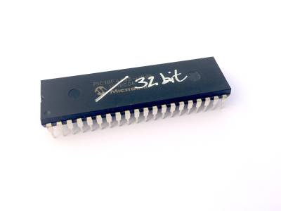

A reduced Core for your MIDIbox App, an STM32F405RG on a DIP40 board size.
Features
  • MIOS32 uses same processor family and drivers(no deep change).
  • Same internal hardware as Disco or wCore (speed, memory, peripherals, etc…) .
  • Board pinout and package compatible with a MIOS8 PIC 8-)
