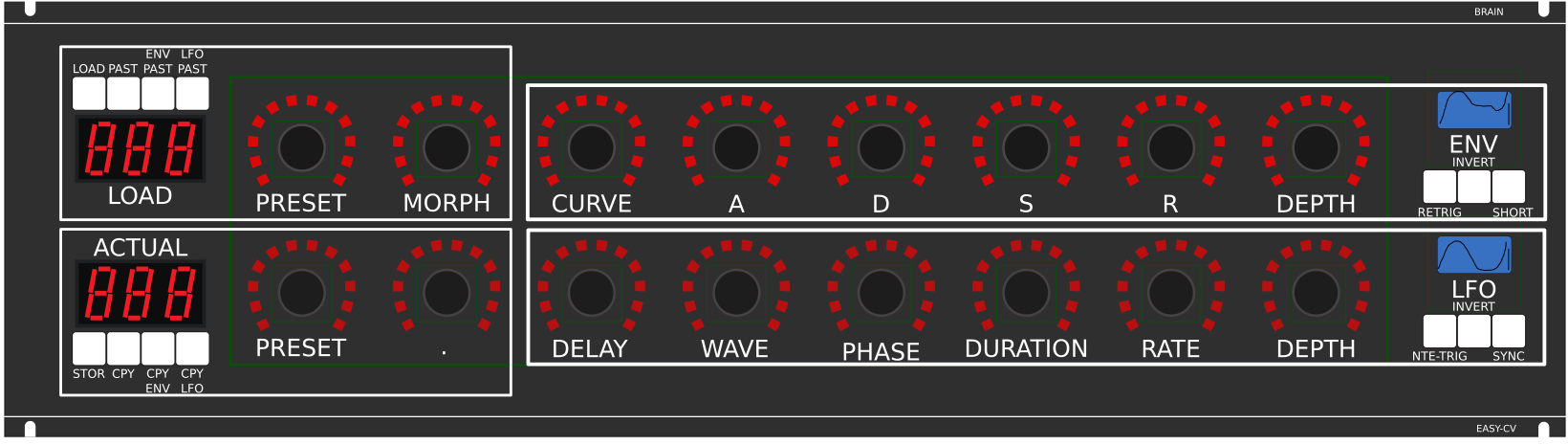

FrontPanel
Brain
THE LEFT SIDE of the BRAIN > Preset-Management:
Save & Load the PROGRAM, can be done by Midi-ProgramChange -or With the LOAD-PRESET-Encoder
then press LOAD -or Morph to the next Program slowly with the MORPH-Encoder
-Another option is to take a PUSH-ENCODER for LOAD & STORE > and load and store it by pushing it… would free 2 buttons for other functions.
MORPH?:
-The Upper 7 Segment LED- Display: is the LOAD Display indicate the new Program with ENV+LFO
-The downer7 Segment LED- Dsipaly: is the STORE Display it indicates also the current Program with ENV+LFO
–with morph you crossfade between both Presets (be carefull, first Store the current Preset
Paste & Copy do their job @ the whole PROGRAM Memory
ENV-PASTE & ENV-COPY do their job @ the selected Envelope > (ENV-Voice selection is done by the breakout Modules) … LFO..same
Midi-Channel Note NR or Number of Envelope is a real programmer job (C), with usb-upload from computer
…. this is a individual device, and once set, it has to play > and it just should do LFOs and Envelopes
Fixed routed, no generic, special > in my case for a filterbank.
THE RIGHT SIDE of the BRAIN > LFO + ENV Settings (one Voice):
ADSR with:
CURVE Paremter which give exponentially to it (no straight lines While Fall and Rise)
Short: just shorten the Maximal lenght of a Envelope, haveing more Feeling on Encoders
should change Scope Display also…
LFO: get synced with Midi, and there is a retrigger by Notes…
Phase: offsets the start-Phase
Delay: simple delay (nte-Trig)
Rate: clear from 8 wholes to 128th or so
Wave: access to the Waveforms
Duration: interpret Midisync in trippled, whole notes or whatever…
DEPTH: is the maximal Value of FALL and RISE and SUSTAIN, i know i loose resolution with this…but i have to have a memory filterbank,…doing depth instead with Potentiometers on Filtermodules… would give no memory…

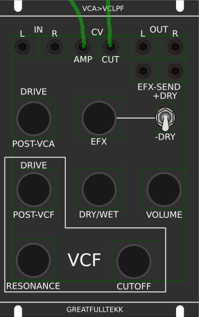

VCA-VCF
THE VCA and the VCF are controlled with each one CV - each CV has a LFO and a ENVELOPE digitaly mixed… fixed in routing.
basicly a simple VCA (MS20Like) that drives the input of a Audio transformator 1:3 which is a Neutrik NTE10-3 (9€)
this “Tesla” Hi Gain - goes now thru the Post-VCA-Gain-Potentiometer - which then overdrives the 303 Filter (my prototype was a Freebase 383)
sound now goes to the Post-VCF-Gain-Potentiometer
now sound goes into a OP-Amp - to have the change for a light overdrive
From this point a EFX-Send Potentiometer send the Processed Signal to a extra Output (EFX-Send)
With the +DRY-Switch, we switch the orginal Signal additional to this EFX-Send-Potentiometer (or not)
Parallel to the EFX-Send Potentiometer is the DRY/WET Potentiometer it Pan between Orginal and Filtered Sound.
after DRY/WET come the Volume-knob and the Audio outs…

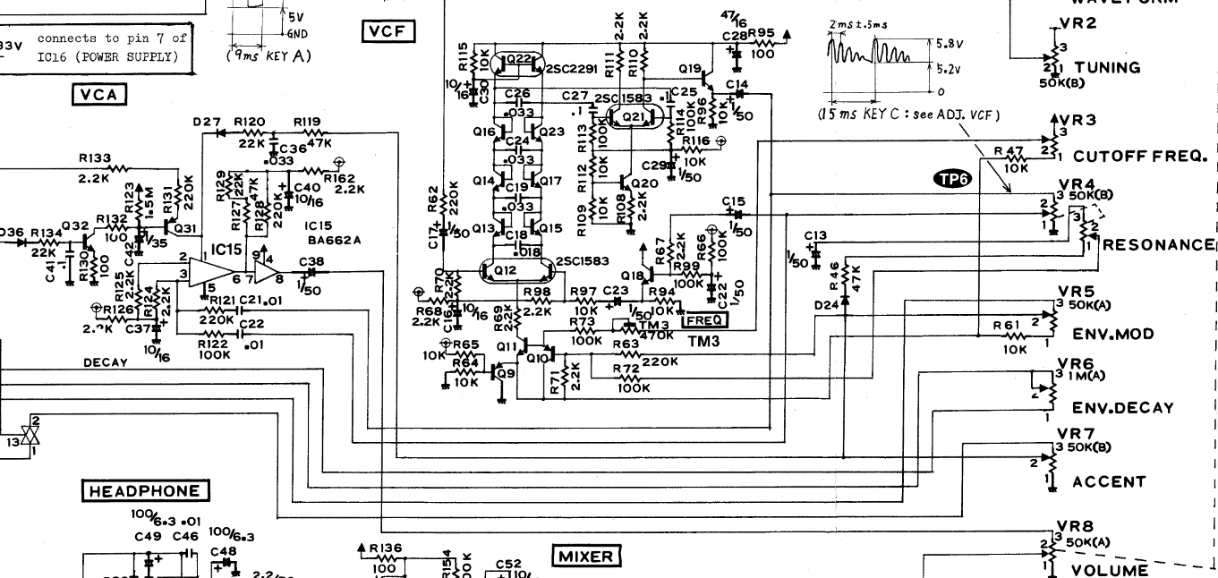

Original Schematics 303 - VCA-VCF

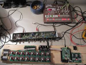

Left-Part of the Brain on Breathboard:
7Segment: LTS547AP
Button: ShadowSE/ITT
3D View of Sandwitches
