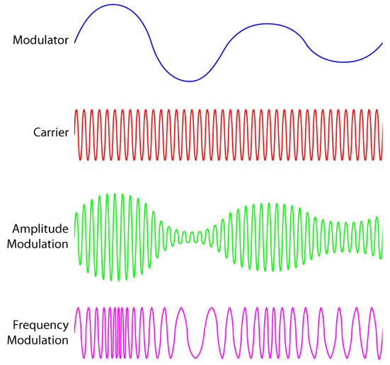

C-Wave Modulation
When you use a signal to modulate an other you have the following:

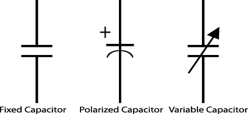

B-Capacitor
The capacitor is a passive component used to store electrical energy temporarily in an electric field with a value in farads . It is sometimes Polarized (Electrolytic), sometimes not (Ceramic)
TODO: Add a link to a Farad converter, remake symbols Gfx
Symbols

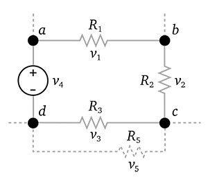

8 - Kirchhoff's Circuit Laws
In electricity , as with water , the flows tend to regulate . The following relationships helps a lot about solving values in circuitry :
TODO: Remake Gfx
A-Current Law (KCL)
In other words , in a node , Current going to the node equals Current going from the node
i4 = i3 + i2 - i1
B-Voltage Law (KVL)
In other words, the voltage is balanced along the components rings ; ad = ab + bc + cd
V4 = V3+V2+V1

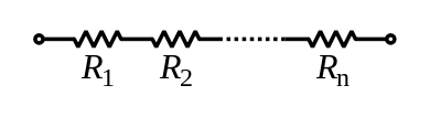

A-Resistors Serial mounted
RTotal = R1 + R2 + … + Rn

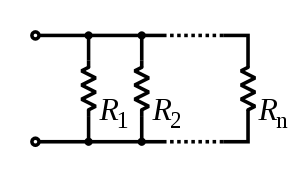

C-Resistors Parallel mounted
(1/RTotal) = (1/R1)+(1/R2)+… +(1/Rn)

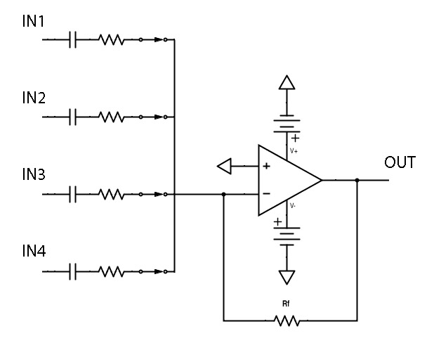

E-Basic Mixer
