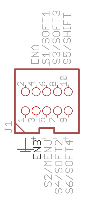

Interconnections
J1 is the SCS header, connecting to J10A
J2 can provide power as indicated; it is also connected on J5.
J5 connects to J15 on the Core (or equivalent)

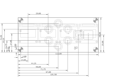

Dimensions
