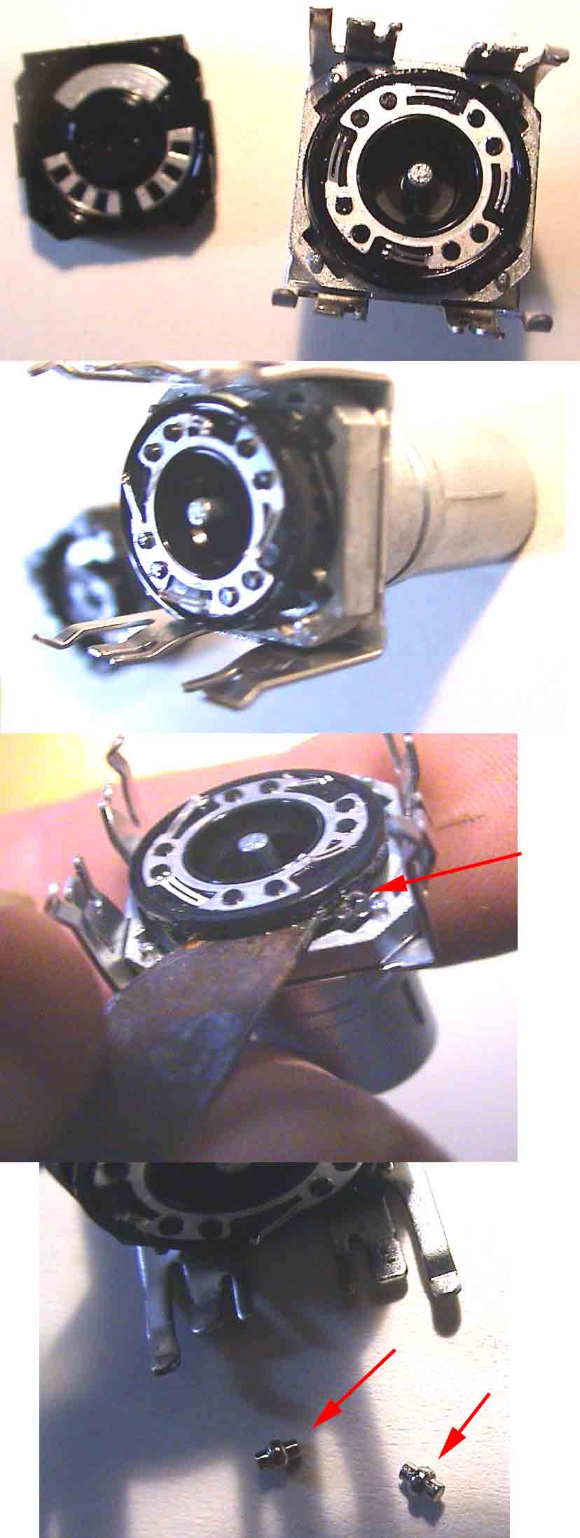

This image describes how to remove detents from http:www.pollin.de encoders:
