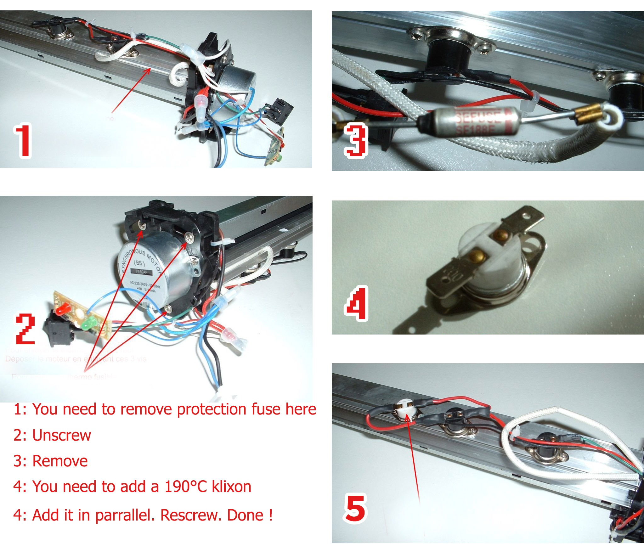

The laminator need a hack to increase heating temperature , but it's a more precise way ta make the transfer than ironer.

Laminator hack
