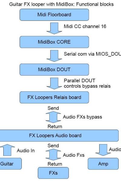

Guitar FX looper with MidiBox
WARNING: THIS PROJECT IS IN PROGRESS SO IT IS NOT FINISHED YET!

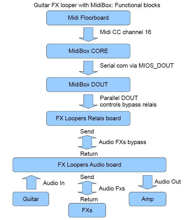

Architecture
Hardware

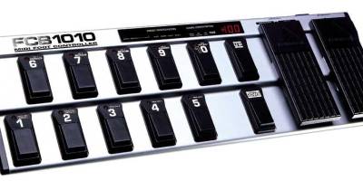

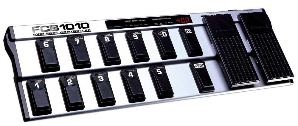

External Controller Midi Floorboard
Use the Behringer FCB1010 floorboard that sends one Midi message when pressing down a knob-controller.
MidiBox
Use the MidiBox as controller that recieves the Midi messages and controls the true bypass switches: www.ucapps.de
MidiBox kits: www.mikes-elektronikseite.de
I need a:
- CORE Module, that I can program to receive the midi from the footcontroller and translate midi program changes into on-off
digital signal outputs. www.ucapps.de/index.html?page=mios_c_set_dout.html
- DOUT Module, the digital outputs that will be set by the CORE module and will control the FX loopers.
NOTE: Only 1/4 of a DOUTx4 module is needed to control 7 relays.
