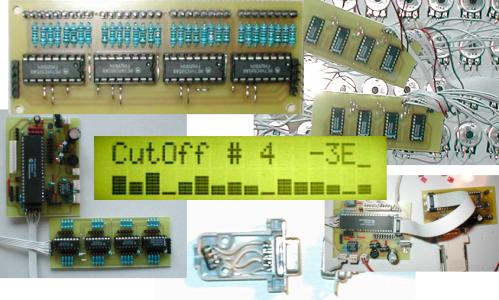

A MIDIbox is an open-source, non-commercial, DIY, hardware MIDI device. It can perform various functions depending on the firmware that is installed and the hardware that is used. The MIDIbox DIY-projects consist of hardware (MBHP) and software (MIOS Operating System + Application). Some projects have special designed modules, others only require a Core module. Every device needs at least one Core.
The normal way to build a MIDIbox MIDI controller or synthesizer is:
- Build the hardware (starting with a Core Module)
- Build the necessary I/O modules (eg LCD, DIN, DOUT)
- Connect the modules and add additional hardware (knobs, faders, encoders, buttons…)
- Burn the bootloader onto the microchip or get yourself a chip with a preburned bootloader from SmashTV or Mike
- Upload MIOS, the operating system (by MIDI; sometimes MIOS is already on the chip!)
- Upload the necessary application (eg MIDIbox64e.hex) by MIDI

MBHP - The MIDIbox Hardware Platform
The MIDIbox Hardware Platform is the consequential continuation of Thorsten Klose's work on MIDI controllers in the last years. It brings down every design to one standardised environment with reusable and exchangeable modules.
Well, this method is nothing new, did you ever saw the inner life of an old television, or a HIFI system, or a computer, or - of course - a modular synthesiser system? All are consisting of smaller or larger units, which interact over dedicated interfaces. This way of thinking, which simplifies the understanding of complex technical applications, is now also promoted by the MBHP.
The focus of the platform:
- well defined and documented modules
- small, uncomplicated circuits
- realizable on PCBs (single-layer) and prototype boards
