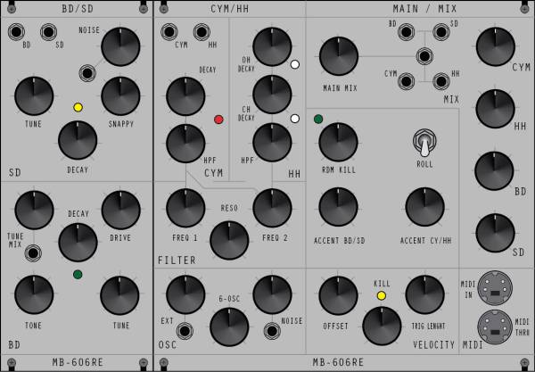

The MB-606RE is a re-edit of CYM/HH and BD/SD drum parts of the Roland TR-606 to be controlled via MIDI (midibox) or CV through analog-Sequencers , in a a Eurorack-designed panel.
Well known Circuit Mods from around Web & time are included by default.
FrontPanel
General Design
The MB-606re is part of the EuroLand Group… (606, 808, 909)/ It can be used in 2 Cases:/ Midi /CV+Trig/ 1. Midi: Use the MB-Modulbox Standartmodules, for Digital UI and CV+Trig-Generation/ 2. CV+Trig: Just Plug CV or Trig Jacks into the Analog Modules…without Midibox./

- 1st PCB : BD+SD UI-PCB / HH+CY UI-PCB »> Breakoutboard+Potentiometer Boards
- 2nd PCB : Analog Circuits
2n PCB: We get the two Analog Circuits (BD+SD / CY/HH) mounted 90° angled with vertical female socket and angled DIL Pinheaders for better heat dissipation
Sandwich view
