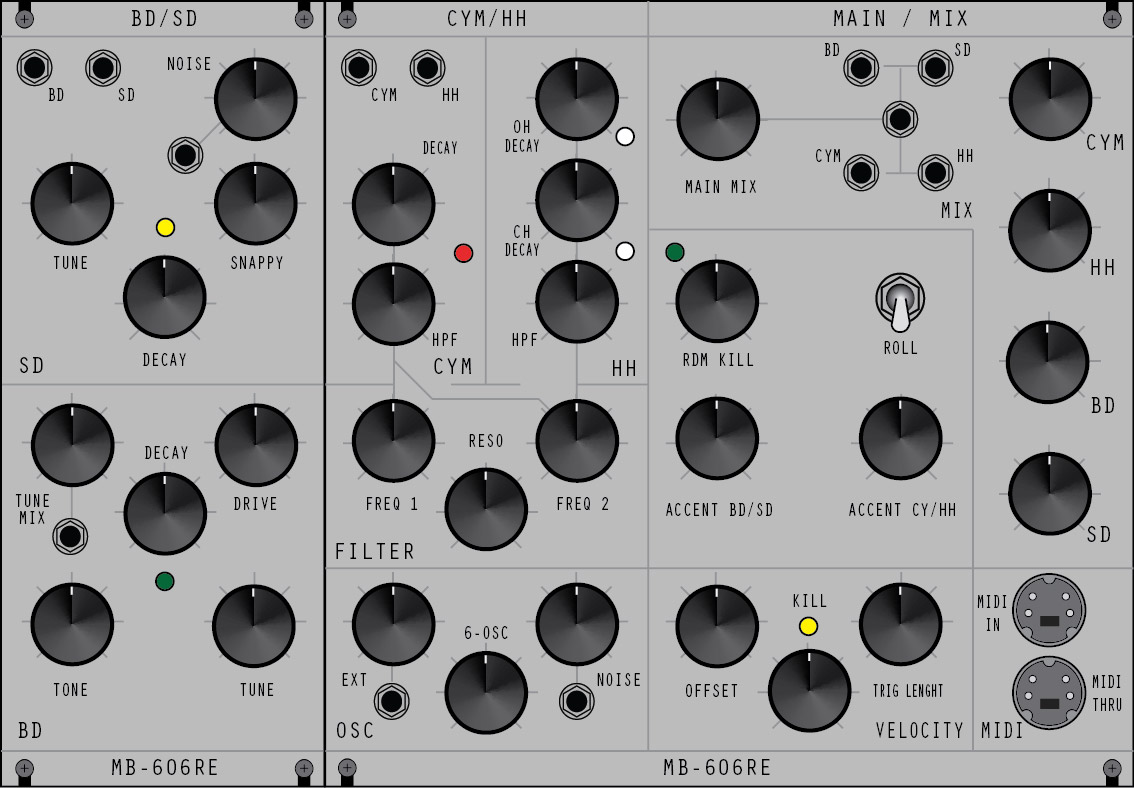

FrontPanel
General Design
The MB-606re is part of the EuroLand Group… (606, 808, 909)

MB-Modulbox Main PCB UI
Access to System-Settings, Channel, NoteNumbers
CV+Trig Out-Jacks for Euroland Drum Modules
MB-Modulbox 8xPotentiometer Module
When using the Euroland Modules via Midi, then there are some Performance Parameters aviable:
All Functions have effect on all 8 Voices @ once.
1.Velocity Offset (-+64 > with Center Postiton = normal)
2.Velocity Kill depending Note Kill (-+64 > with Center Position = normal > Full Spectrum)
3.Random Kill (0=full Kill, 127 no Kill, Normal Position > 127)
4.Velocity 2 TriggerLength (-+64 > with Center Position = normal 10ms, turn right:time inc by velocity in%, turn left:decrease%)
5.Accent: (0-127-normal 127)
6.——: could be something like Roll
7.——: not used, could be something like a Accent for a Group of CVs
8.——: not used, could be something like a Accent for a Group of CVs
accessable via MB-Modulbox 8xPot - PCB. Just plug it in, and acitivate the AIN-Port in MIOS

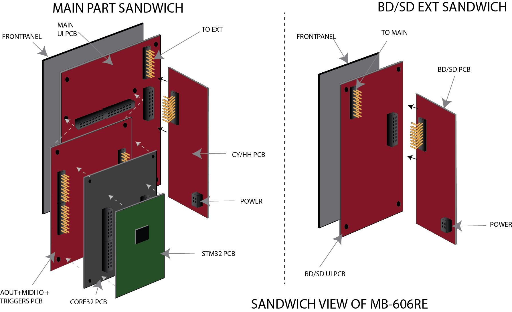

606 BD+SD, 606 HH+CY
To spare Space: we sandwich in 2 layers
- 1st PCB : BD+SD UI-PCB / HH+CY UI-PCB »> Breakoutboard+Potentiometer Boards
- 2nd PCB : Analog Circuits: 2n We get the Analog Circuits mounted 90° angled with vertical female socket and angled DIL Pinheaders for better heat dissipation
Sandwich view - Analog Boards
