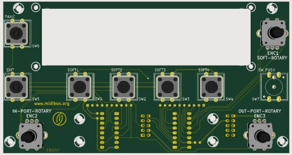

The prototype of the user interface (UI) already shows the main usage paradigm: a rotary encoder (on the lower right) is used to select the out port, thereafter the in port is selected with the rotary encoder on the left. This selection is confirmed by pressing the encoder. More changes to the current routing can be made, and when pressing the lower right rotary encoder, all changes are made effective and the routing is changed.
The buttons and encoder in the upper row, just below the display, belong to the SCS based menu system and will enter the config pages. Here, you can also load and save “patches” and configure the two mergers. The lower row of buttons doesn't do anything, except for one which is used for triggering a PANIC function, sending note off messages on all MIDI channels to all out ports.

The user interface (UI) is based on the MIDIbox SCS, two dedicated clickable encoders for in- and out-port selection, and an additional PANIC button. It fits in the frontpanel of a standard 2U rack case, offers a 2×24 display for feedback, and 5 buttons along with an encoder for navigating the menu system. So far, an alpha prototype version of the board has been tested successfully on veroboard.
A second generation PCB as modeled above will be ordered soon. This PCB can also be used with other projects involving an SCS, e.g. the MIDIbox NG. Both, my favourite switches from Marquardt (6425 series), as well as the E-Switch TL1100 series (see e.g. MB SEQv4) can be used.
