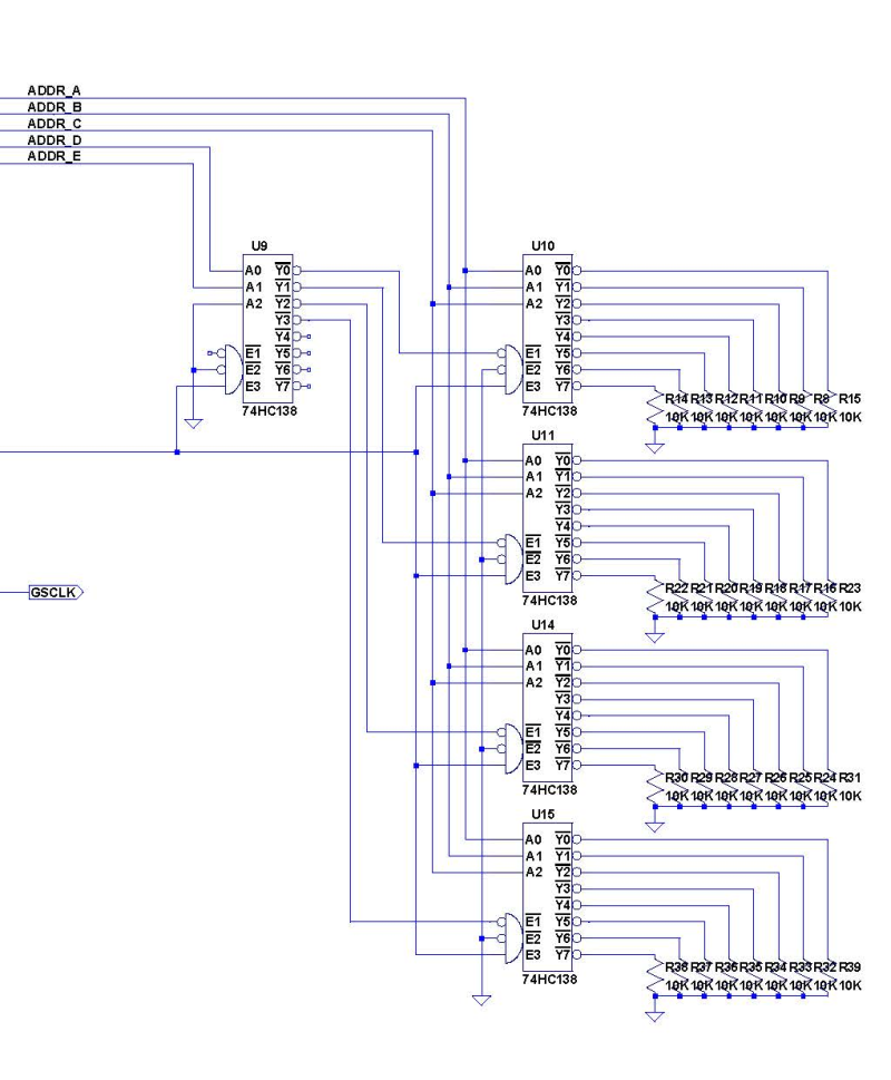

Multiplexing Schematic
ADDR_x, ADDR_CLK, GSCLK are connected to the top board…
ADDR_CLK is the multiplexed lines clock . It's used to gate the PWM signal and obtain the GSCLK and of course, as a clock for the ADDR Counter U5. The counter U5 provides the coded ADDR_x lines and an EOF(End Of Frame) when 32 is reached.
