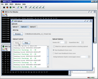

HEX Upload
Hex Upload: The MIOS code upload is very comfortable - you don't need to generate a .syx anymore, HEX files can be uploaded directly:
You should ALWAYS use 'Smart Mode', and enable 'Wait for Upload Request', and then power on your core after hitting 'Start'. ALWAYS. If this doesn't work, there's something wrong, and you should begin troubleshooting as per the uCApps MIDI Troubleshooting page. ALWAYS!!! :)
