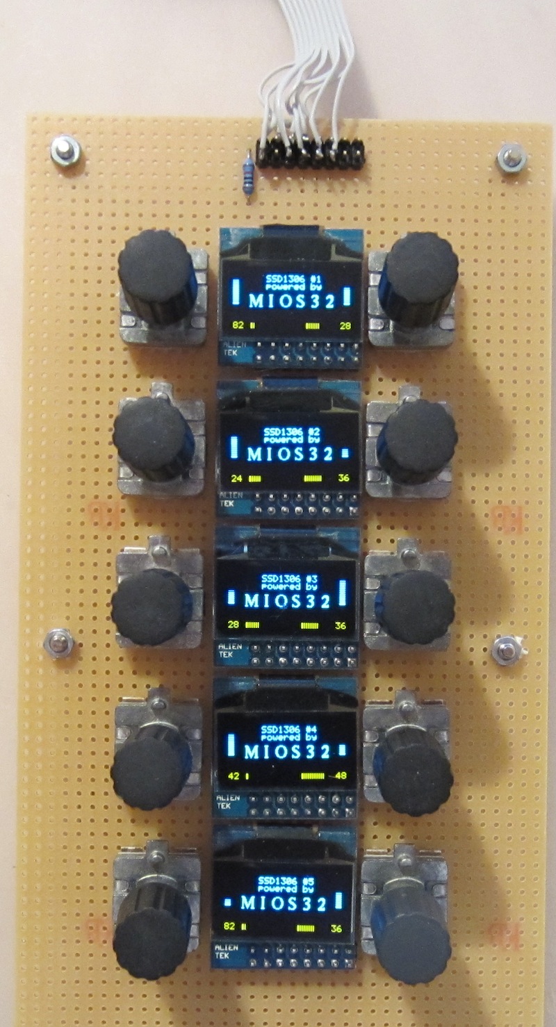

OLED Displays devices provides better luminosity than a classical backlighted LCD. You can plug it as a LCD to your core module. It can be CLCD or GLCD.
Supported Tested References

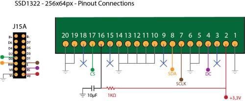

- SSD1306 based
- SSD1322 based
Connections
