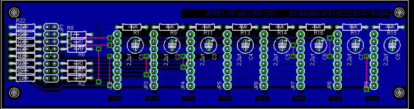

With the following Circuit/PCB you can drive up to 8 of this nice Nokia-3310-LCDisplays on a single Core-Module
Click on the Images to enlarge…
Schematic
based on this schematics…
Single Sodering
All 8..
PCB
farm2.static.flickr.com_1327_659362925_b9c9b3208b_o.jpg farm2.static.flickr.com_1103_698889372_2144531f0f_o.jpg farm2.static.flickr.com_1418_661222350_3c789e747c_o.jpg
in Action ;)
