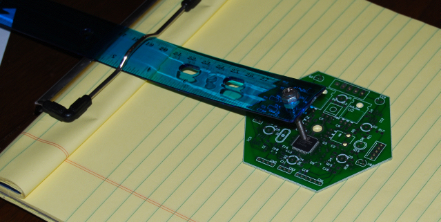

Soldering surface mount parts: There are many ways, from “wave” soldering to mask soldering, to baking them in a converted toaster oven. The biggest problem I had when hand soldering was keeping the chip in place. I could get it located perfectly, but as soon as I touch it with the tip of the iron, it would stick to the iron and all was lost. I fixed this with a simple tool anyone can make with stuff that is laying around the house. Take a ruler, or anything that resembles one, and add a small hole in one end if it's not there already. Then add a screw and a nut through the end. Find a clipboard, and use this under the clip to hold parts in place. Here's a quick picture, though I would prefer a wooden ruler.
That chip will stay put easily while soldering, and the ruler puts only a LIGHT pressure on the chip, so nothing gets damaged. No, that's not a MBMixer board, those have not arrived yet. (But it is a PIC18F458, alternate core, anyone?)
Once the chip is held down, just rest the tip of your iron so that it touches the end of each leg and the circuit board at the same time. Just a touch of solder and it should flow between the leg and board. Don't hold the iron there too long, chips can be damaged by too much heat.
