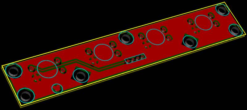

PRINTED CIRCUIT BOARD (PCB)
I decided to screw pots directly on the frontpanel in order to be sure about solidity when I'd use them.
For buttons and leds, I decided to make my own PCB.
I used Kicad, a VERY reliable “open source (GPL) software for the creation of electronic schematic diagrams and printed circuit board artwork”.
I made all the components with datasheet informations in order to be sure my PCB would fit reality.
I ordered PCB from batchpcb.com. They are in USA, I'm in France. It took around 3-4 weeks. Long time when you're as impatient as me, but a correct delay considering the reliability of PCB you receive at home !!!
I made 7 PCBs.
Here are some 3D rendering from Kicad/wings3D in order to see what I expected.
NB: if you checked a bit, you'll find an error. Indeed. and even 2 errors on the big PCB… I had to re-order it in order to get a correctly done PCB.
I put midibox modules at the bottom face and my 7 own PCBs under the frontpanel
I glued the screws under the frontpanel (Denis St Amand adviced it and … as usual was right!)
I guess I'll modify asap the modules place. Indeed too much cable between the bottom and the frontpanel: it would be better to directly put all modules under the frontpanel, excepted the core at the bottom…
