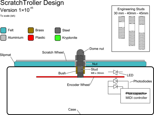

Here is the assembly diagram.
Notes/Hints :
  • There should be washers between the nuts and the scratch wheel.
  • Solder a wire to the brass bush (connects to “TOUCH SENSOR” in the schematic) - this enables the scratch wheel to act as a big capacitive touch sensor.
  • Glue the encoder wheel to a nut - then you can just screw it on to the bottom part of the stud.

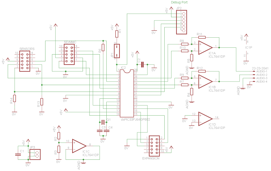

Schematics
This schematic shows how to wire everything up to the PIC. Should be trivially adaptable to work with a “real” midibox core module.
