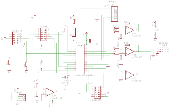

Schematics
This schematic shows how to wire everything up to the PIC. Should be trivially adaptable to work with a “real” midibox core module.
