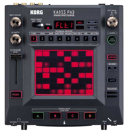

Korg Kaoss Pad 3
The new version 3 Korg Kaoss Pad is a combined tempo-based effects unit, sampler, synth and drum machine. Under the large touch panel is a grid of 8 x 8 LEDs to show pattern programming.
