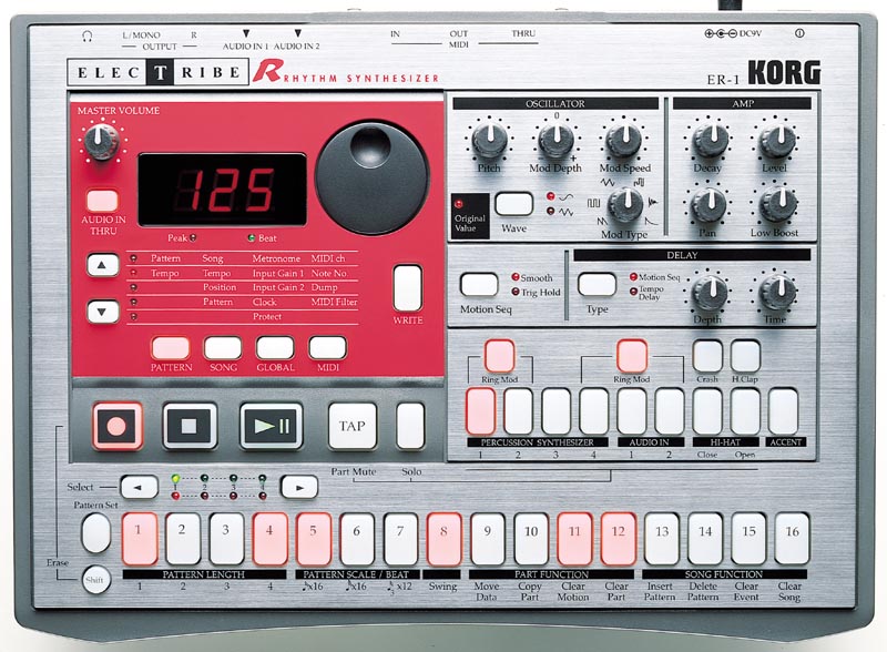

Another approach is found in the Korg ER-1 (below), in which a pattern is 64 steps by default, but only 16 steps are visible. While at first this sounds similar to the Roland TR series, the ER-1 does not “page flip” as the sequencer moves on to steps that aren't visible. Instead, you're able to select which 16 steps you're editing independently of the 16 steps which are playing.

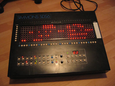

SDS6
www.simmons.synth.net_sds6_pics_sds6_04_s.jpgImage © Paul Maddox
Another variant is the discontinued Simmons SDS6 with one row of buttons for steps, but a LED matrix display of 32 steps x 8 instruments for a full view of the current pattern. A column of 8 buttons beside the display allows instant selection of the instrument for programming on the pattern buttons.

Electribe
www.harmony-central.com_events_wnamm99_korg_er-1-large.jpg© Korg and Harmony Central
  • The Electribe ER-1. Notice the LEDs just above the 16 step buttons. 4 LEDs tell you which 16 steps are currently playing, and the other 4 tell you which 16 steps you are currently editing.

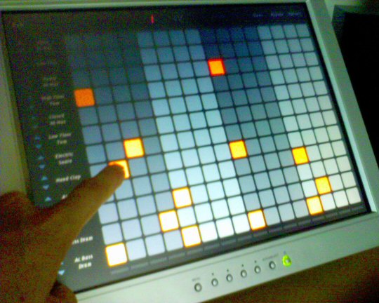

gcontrol
This software drum pattern editor for touch monitors turned up in the comments to this article on Music Thing. The author appears to be offering it free to anyone who wants to try it out.
