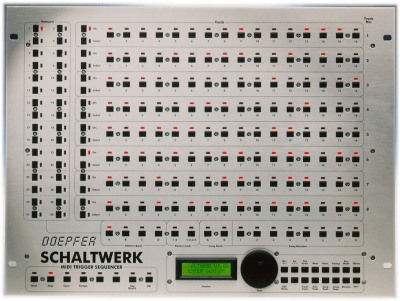

Schaltwerk
© doepfer.de
A “two-dimensional” TR-style sequencer exists/existed, the now discontinued
Doepfer Schaltwerk.
There have been several posts in the forums from people craving a sequencer like this. It is essentially a TR-style sequencer, but with an actual row of buttons for each track, instead of a UI which requires you to switch the existing row to the track you want to work on.

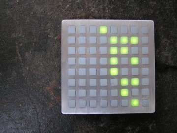

Monome
Image © monome.org
A combination matrix of buttons and LEDs may be possible with lighted buttons, similar to the
Monome, which is not a sequencer in itself, but a USB human interface device which can have sequencer-like functionality depending on the host software.

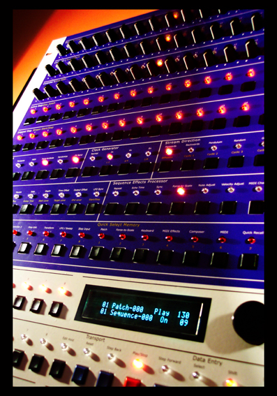

Octopus
© Genoqs.net
From the documentation on the
genoQs web site, this appears to be the mother of all matrix pattern sequencers (with a price tag to prove it). Posted here primarily due to its pure beauty!
