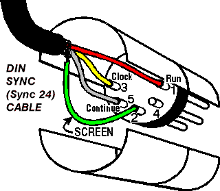

Sync24 Connector
Sync24 Connectors Are Not MIDI Cables
Dont use midi cables as sync24 cables, because the wiring is different, and most often, the pins 1 and 5 used by sync 24 are left unwired in midi cables.
