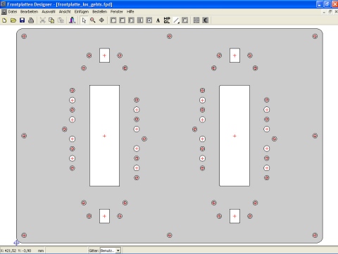

Frontpanel Designer template: midiboxuc_frontpanel.zip
