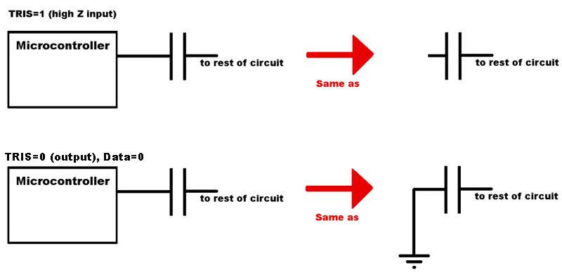

Digital: Digital capacitors
I'll let Afroman do the talking, but a couple of stolen JPEGs should give you the general idea. He extends the principle to the construction of digitally controlled LC filters and oscillators.
Repeat to desired bitwidth
