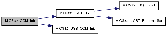

s32 MIOS32_COM_Init ( u32  mode  )
Initializes COM layer
Parameters:
[in] mode currently only mode 0 supported
Returns:
< 0 if initialisation failed

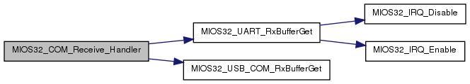

s32 MIOS32_COM_Receive_Handler ( void   )
Checks for incoming COM messages, calls the callback function which has been installed via MIOS32_COM_ReceiveCallback_Init()
Not for use in an application - this function is called by by a task in the programming model!
Returns:
< 0 on errors

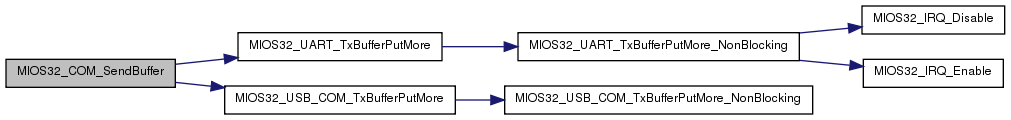

s32 MIOS32_COM_SendBuffer ( mios32_com_port_t  port,
u8 buffer,
u16  len
Sends a package over given port (blocking function)
Parameters:
[in] port COM port (DEFAULT, USB0..USB7, UART0..UART1, IIC0..IIC7)
[in] buffer character buffer
[in] len buffer length
Returns:
-1 if port not available
0 on success

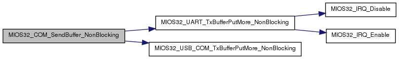

s32 MIOS32_COM_SendBuffer_NonBlocking ( mios32_com_port_t  port,
u8 buffer,
u16  len
Parameters:
Returns:
-2 if non-blocking mode activated: buffer is full caller should retry until buffer is free again
0 on success

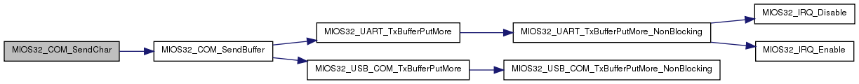

s32 MIOS32_COM_SendChar ( mios32_com_port_t  port,
char  c
Sends a single character over given port (blocking function)
Parameters:
[in] c character
Returns:
0 on success

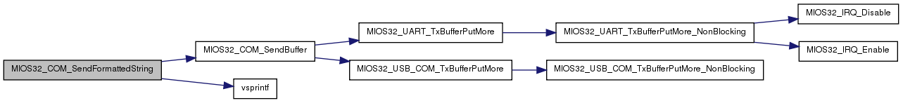

s32 MIOS32_COM_SendFormattedString ( mios32_com_port_t  port,
char *  format,
Sends a formatted string (-> printf) over given port (blocking function)
Parameters:
[in] *format zero-terminated format string - 128 characters supported maximum!
[in] ... optional arguments,
Returns:
0 on success

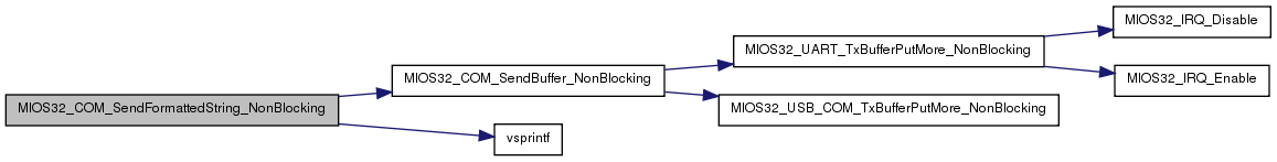

s32 MIOS32_COM_SendFormattedString_NonBlocking ( mios32_com_port_t  port,
char *  format,
Parameters:
[in] ... optional arguments, 128 characters supported maximum!
Returns:
0 on success

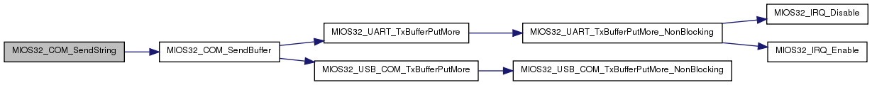

s32 MIOS32_COM_SendString ( mios32_com_port_t  port,
char *  str
Sends a string over given port (blocking function)
Parameters:
[in] str zero-terminated string
Returns:
0 on success

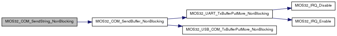

s32 MIOS32_COM_SendString_NonBlocking ( mios32_com_port_t  port,
char *  str
Parameters:
Returns:
-2 buffer is full caller should retry until buffer is free again
0 on success
