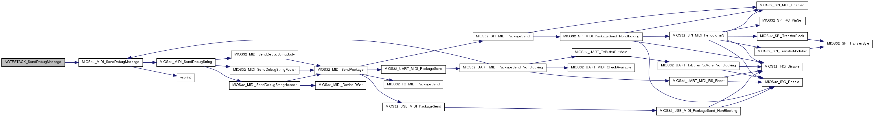

s32 NOTESTACK_SendDebugMessage ( notestack_t n  )
Sends the content of the Notestack to the MIOS Terminal
Parameters:
[in] *n pointer to notestack structure
Returns:
< 0 on errors
