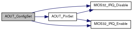

s32 AOUT_ConfigSet ( aout_config_t  config  )
Configures the AOUT driver.
It is recommented to call AOUT_IF_Init() if a different AOUT interface type has been selected (e.g. switch from MBHP_AOUT to MBHP_AOUT_NG)
Parameters:
[in] config a structure with following members:
  • config.if_type: selects the interface
  • config.if_option: allows to pass additional options to the IF driver
  • config.num_channels: number of channels (1..AOUT_NUM_CHANNELS)
  • config.chn_inverted: allows to invert the output of AOUT pins (each pin has a dedicated bit)
Returns:
< 0 if initialisation failed

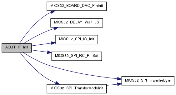

s32 AOUT_IF_Init ( u32  mode  )
This function re-initializes the AOUT module, and requests a refresh of all output channels according to the stored values in aout_values
The update will take place once AOUT_Update is called (e.g. from a periodically called task)
Background info: the AOUT_PinSet function only request an update if the output value has been changed (comparison between new and previous value) This improves performance a lot, especially when AOUT values are written periodically from a timer interrupt (see MIDIbox SID and MIDIbox FM)
However, sometimes it is useful to force a refresh, e.g. after a patch change, to ensure that all AOUT channels are up-to-date, because it allows to connect (or exchange) the AOUT module during runtime.
This function is also important after a configuration update, e.g. after a different AOUT interface type has been selected.
Parameters:
[in] mode currently only mode 0 supported
Returns:

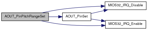

s32 AOUT_PinPitchRangeSet ( u8  pin,
u8  value
This function sets the pitch range for an output channel
Parameters:
[in] pin the pin number (0..AOUT_NUM_CHANNELS-1)
[in] value the pitch range (0..127) - only values between 2..12 are really useful
Returns:
-1 if pin not available
0 on success

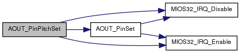

s32 AOUT_PinPitchSet ( u8  pin,
s16  value
This function sets the pitch offset for an output channel
Parameters:
[in] value the pitch (-0x8000..+0x7fff)
Returns:
0 on success

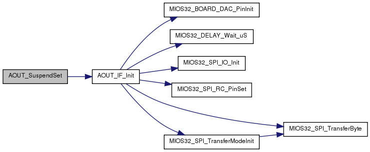

s32 AOUT_SuspendSet ( u8  suspend  )
This function allows to suspend any updates until suspend will be deactived
Parameters:
[in] suspend if 1: AOUT_Update() has no effect, if 0: module will be re-initialized via AOUT_IF_Init(0) and AOUT_Update() works again
Returns:
< 0 on errors

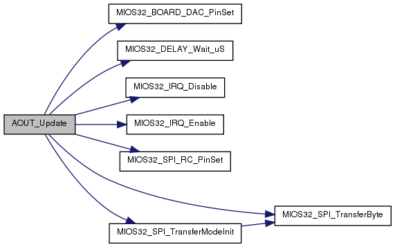

s32 AOUT_Update ( void   )
Updates the output channels of the connected AOUT module
Should be called, whenever changes have been requested via AOUT_Pin*Set or AOUT_DigitalPin*Set
Returns:
< 0 on errors
