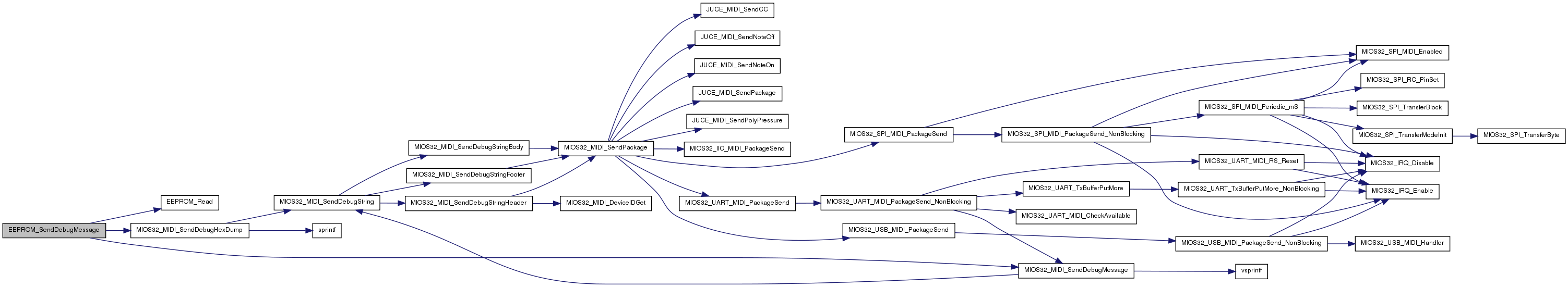

s32 EEPROM_SendDebugMessage ( u32  mode  )
Sends the EEPROM content and optionally the whole flash page content to the MIOS Terminal
Parameters:
[in] mode following modes are provided:
  • 0: send EEPROM content
  • 1: send content of flash pages
  • 2: send EEPROM content and flash pages
Returns:
< 0 on errors
