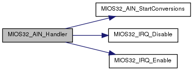

| s32 | MIOS32_AIN_Handler (void *_callback) |
| s32 | MIOS32_AIN_StartConversions (void) |

| s32 MIOS32_AIN_Handler | ( | void * | _callback | ) |
