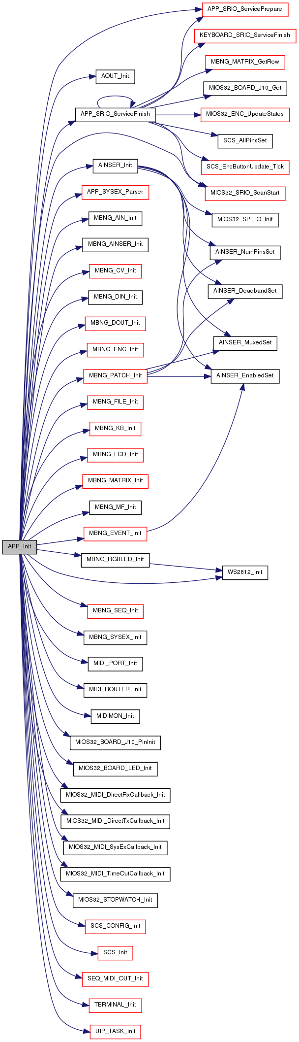

void APP_Init ( void   )
This hook is called after startup to initialize the application

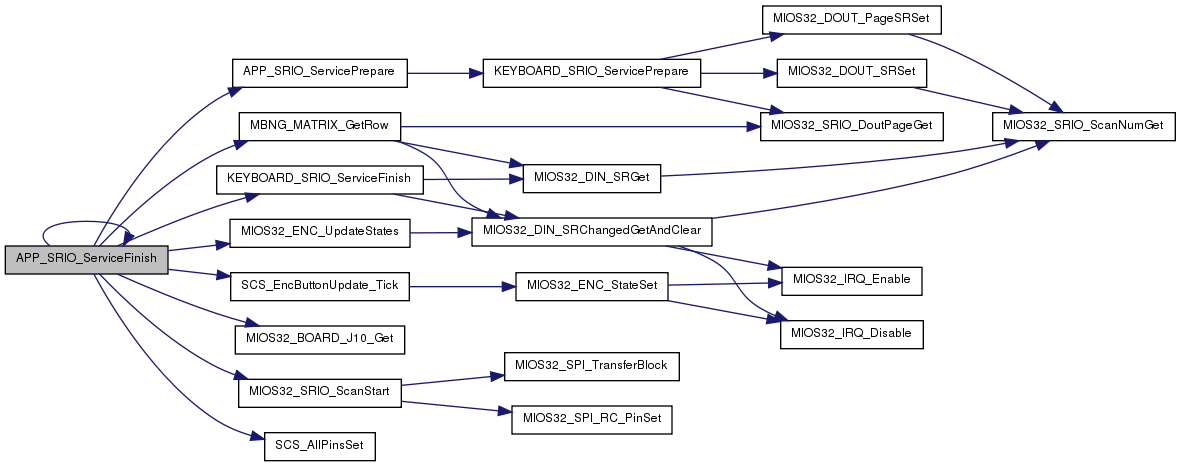

void APP_SRIO_ServiceFinish ( void   )
This hook is called after the shift register chain has been scanned

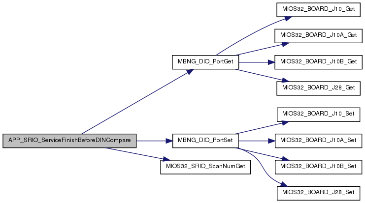

void APP_SRIO_ServiceFinishBeforeDINCompare ( void   )
This hook is called after the shift register chain has been scanned and before the DIN registers will be compared (hook enabled via define MIOS32_SRIO_CALLBACK_BEFORE_DIN_COMPARE in mios32_config.h)

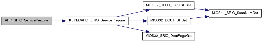

void APP_SRIO_ServicePrepare ( void   )
This hook is called before the shift register chain is scanned

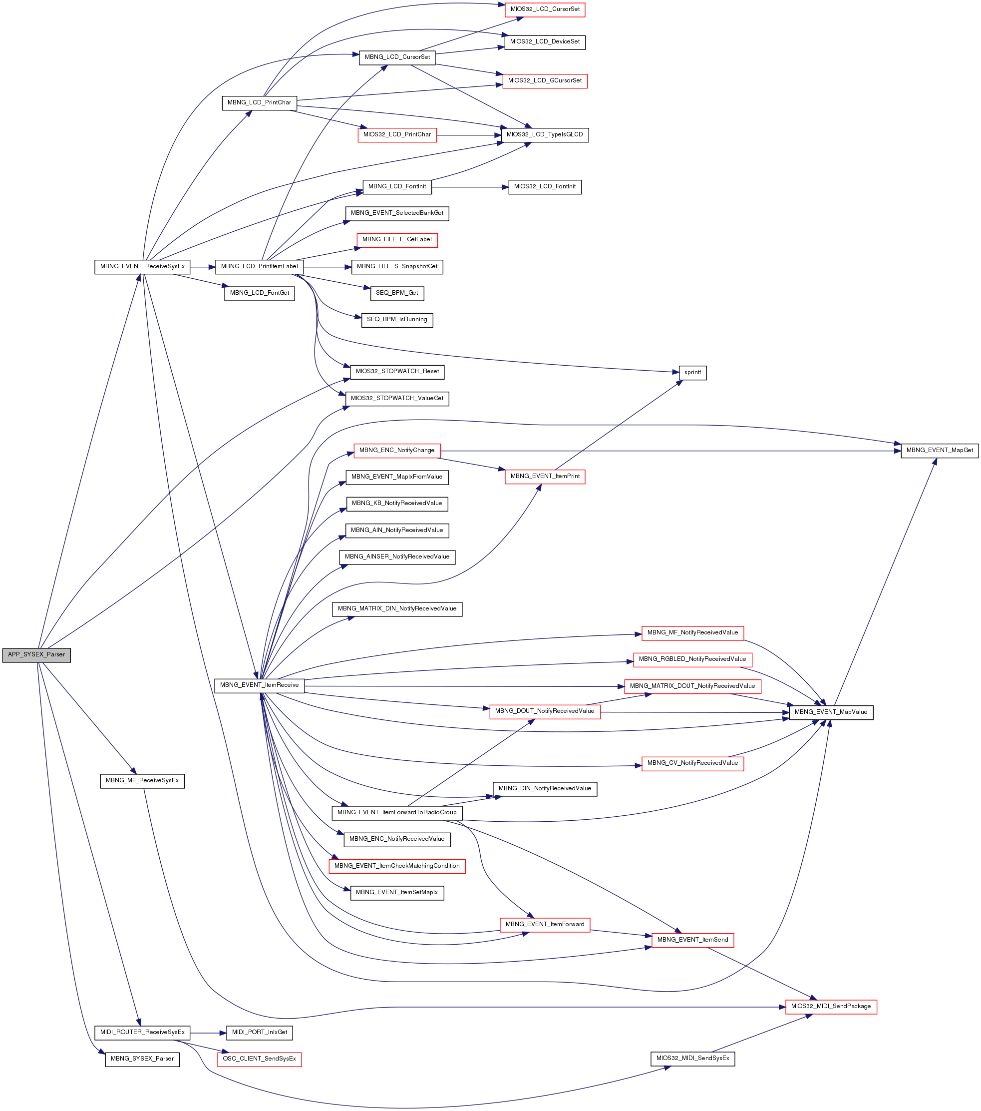

s32 APP_SYSEX_Parser ( mios32_midi_port_t  port,
u8  midi_in
This function parses an incoming sysex stream for MIOS32 commands

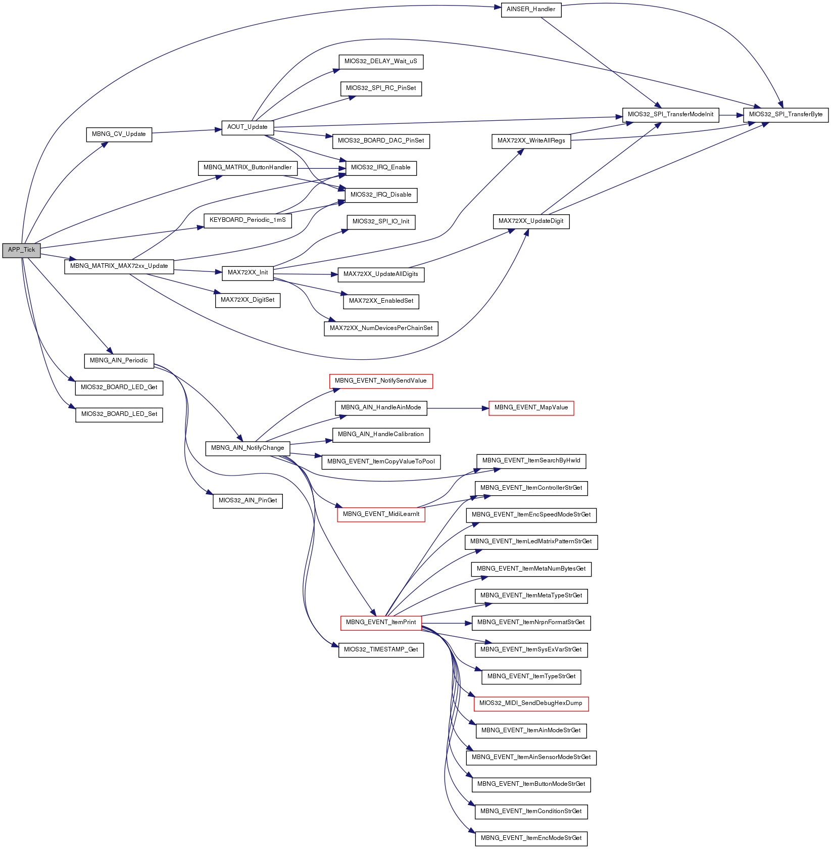

void APP_Tick ( void   )
This hook is called each mS from the main task which also handles DIN, ENC and AIN events. You could add more jobs here, but they shouldn't consume more than 300 uS to ensure the responsiveness of buttons, encoders, pots. Alternatively you could create a dedicated task for application specific jobs as explained in $MIOS32_PATH/apps/tutorials/006_rtos_tasks

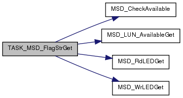

s32 TASK_MSD_FlagStrGet ( char  str[5]  )
