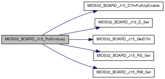

s32 MIOS32_BOARD_J15_PollUnbusy ( u8  lcd,
u32  time_out
This function is used by LCD drivers under $MIOS32_PATH/modules/app_lcd to poll the busy bit (D7) of a LCD
Parameters:
[in] lcd display port (0=J15A, 1=J15B)
[in] time_out how many times should the busy bit be polled?
Returns:
-1 if LCD not available
-2 on timeout return >= 0 on success
