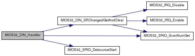

s32 MIOS32_DIN_Handler ( void *  _callback  )
Checks for pin changes, and calls given callback function with following parameters:
   void DIN_NotifyToggle(u32 pin, u32 value)

u8 MIOS32_DIN_SRChangedGetAndClear ( u32  sr,
u8  mask
Returns the DIN pin toggle notifications after a SRIO scan. Should be used to check and clear these flags when processed by a DIN handler for exclusive access (avoid propagation of already handled DIN pin changes)
Examples:
1) if a scan matrix handler processes the DIN pins of the first SR, it should call
   changed = MIOS32_DIN_SRChangedGetAndClear(0, 0xff)
to get a notification, if (and which) pins have toggled during the last scan. The flags will be cleared, so that the remaining handlers won't process the pins of the first DIN register anymore.
2) it's also possible, to check and clear only dedicated pins of the DIN register by applying a different pin mask. E.g.
   changed = MIOS32_DIN_SRChangedGetAndClear(0, 0xc0)
will only check/clear D6 and D7 of the DIN register, the remaining toggle notifications won't be touched and will be forwarded to remaining handlers
