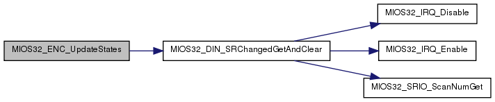

s32 MIOS32_ENC_UpdateStates ( void   )
This function has to be called after a SRIO scan to update encoder states
Returns:
< 0 on errors
